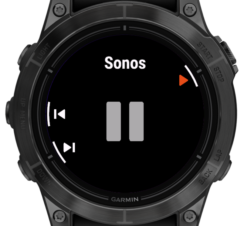

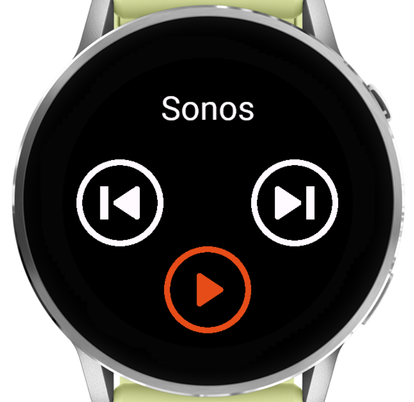

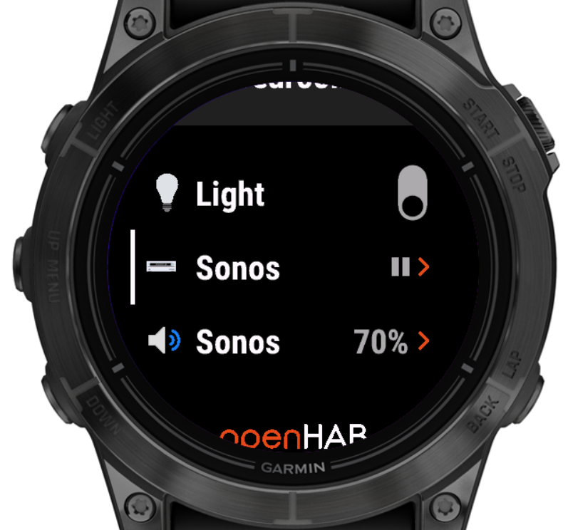

Good afternoon,
I’ve just uploaded version 1.1.0 of the app. This release includes:
  • A custom view for switch elements with item type Player, featuring dedicated play/pause, next, and previous controls.
  • New icons: mediacontrol, player, soundvolumne
Here are some screenshots, first showing the menu item, followed by the full-screen views in both button-based and touch-based layouts:
