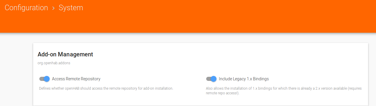

Super naive question I’m sure (sorry!) but since it seems like this has been in for a while, why don’t I see this under Add-ons → Bindings in Paper UI for openHAB 2.4.0 Build #1406? If I search for weather I get:
  • Weather Binding
  • WeatherUnderground Binding
  • Yahoo Weather Binding
You add ons have been upgraded…
Yahoo was removed in 2.4
Did you do this?
Are you on openhabian? or what platform?
I don’t have include legacy switched on, but yes I’m on openhabian.
I don’t know how I still had yahoo-weather if it was removed in 2.4 - I don’t see it in addons.cfg. :frowning:
If you had it installed previously it will stay there. It’s just not available anymore.
On openhabian, run the config tool and make sure that the addons are updated

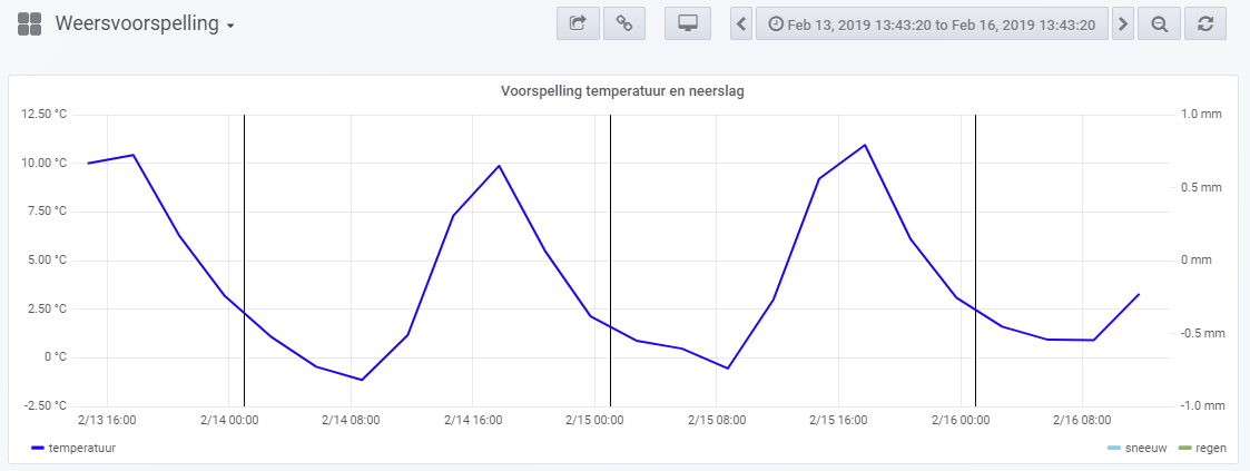

I wanted to do a similar thing, but using Grafana. I solved it with database views.
First, I created a view on each item table, picking up the latest entry and applying a time shift, for example for the snow prediction:
CREATE DEFINER = 'openhab'@'localhost' VIEW Snow30 AS SELECT  30 AS `hours`,  ADDDATE(  NOW(), INTERVAL 30 HOUR) AS `forecastdate`,  `Item560`.`Value` AS `Value`FROM `Item560`ORDER BY `Item560`.`Time` DESC LIMIT 1;

Then I made a union view to pull each record of the above views in one query:

I did the same for rain and temperature, and use these three as data sources for a Grafana chart. Unfortunately we are not expecting rain or snow in the coming days, so my chart is pretty boring right now:
I see. You’re using MySQL views to generate the data set to graph through Grafana.
At the moment I’m experimenting with InfluxDB and hence I’m still sorting my way into getting the same result. Persisting all forecast data is already a first precondition that I can easily satisfy. Once I have my first forecast data stored, I’ll then be able to experiment in Grafana.
