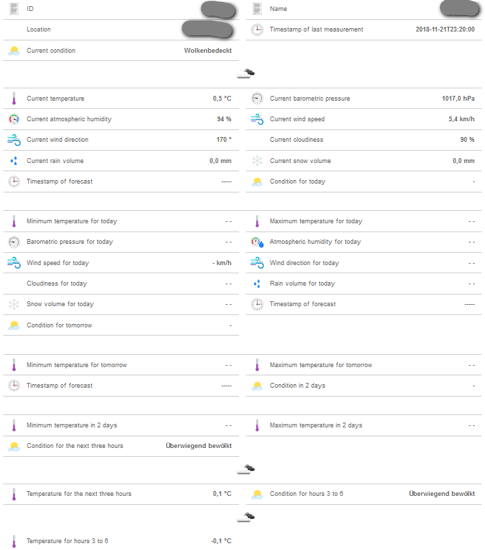

The result looks like this:
grafik
As one can see, a lot of the items are not filled with values.
The logger gives the following messages:

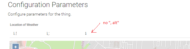

Also: If I add the altitude in the location of the Thing, I get the classic ManagedThingProvider WARN. I believe this is because PaperUI “trims” the altitude from the Thing conf page and tries then to update the Thing with only lat/long but it can’t because the Thing is not Managed (see here also: Finally, I got rid of this AbstractManagedProvider warning)
I have the same issue with PaperUI also for the Astro binding (trimming of alt). I think that I should open up an issue for PaperUI…
Results in Warn:
Bridge	openweathermap:weather-api:api	"OpenWeatherMap Account" @ "Weather" [ apikey="abc123", refreshInterval=30, language="en" ]
	Thing weather-and-forecast local "HomeR Weather & Forecast" @ "Weather" [ location="xx.xxx,yy.yyy,0", forecastHours=120, forecastDays=7 ]
Works ok (without alt):
	Thing weather-and-forecast local "HomeR Weather & Forecast" @ "Weather" [ location="xx.xxx,yy.yyy", forecastHours=120, forecastDays=7 ]
@fibu-freak Do you own a paid account for OWM? If not, the daily forecast will not work.
@Dim Why not contribute your ideas directly? Otherwise share them in this thread.
Yes, could be worth to do some further investigations on that issue. I saw this message from time to time in my life too. But never related them to a geographically location configuration …
No paid account, only free one. Does this mean that my Bridge/Thing is wrong, as using it now ?
So does that mean i can’t use the parameter “forecastDays” or set it to zero ?
Yes, exactly. Unfortunately, that is one of the biggest disadvantages of the OWM API. :slightly_frowning_face:
