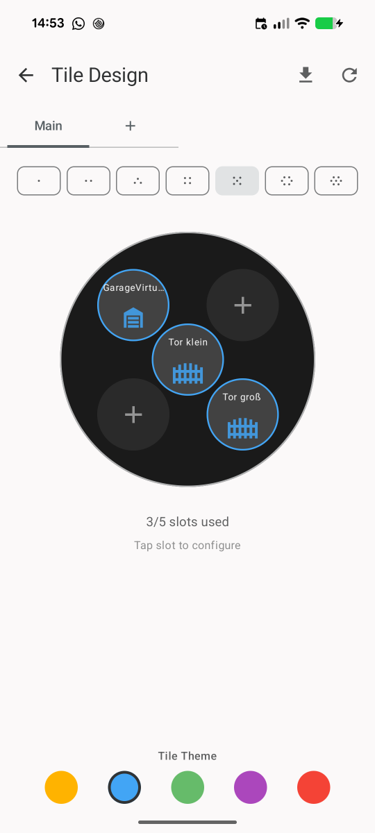

  • Visual Tile Design editor — pick icons (MDI / Material / openHAB), arrange items, preview the layout

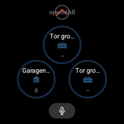

Edit: Got the watch APK installed now. Did some tile setup and saved it. The phone app now offers syncing it to the watch, which I did; app says ‘Credentials & tile config synced’. I’ve assigned 3/5 slots for now:
But tile arrangement on watch looks both different and wrong (labels don’t match up, one ‘Tor klein’ became ‘Tor groß’):
(Also the icon + label on top look a bit off?)
When tapping either of the 3 items (one is a roller shutter, the other two just execute a command) nothing seems to happen: no UI feedback, no action is performed.
