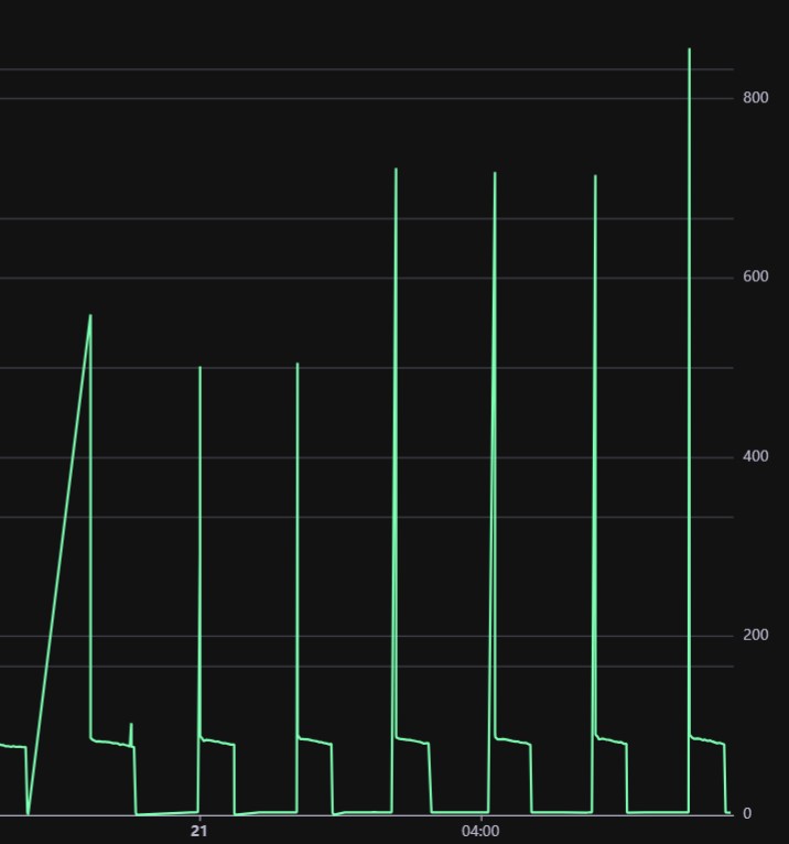

This is my Fridge with reporting every 5 seconds, you can see the usage rests at 0 for long periods, then spikes up to ~500 watts briefly as the pump starts:

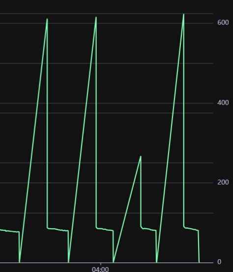

This is the same device after changing to 10%

You don’t need to mess with what’s persisted. You just need to adjust how it’s charted.
MainUI Charts are built using Apache ECharts and while MainUI only presents a few of the more common options to you in the forms, you can add any property supported by ECharts to the YAML config.
So in this case, you want to change how the line transitions from one value to the next. The default is to not step. It directly connects one point to the next which gives that saw-tooth appearance to the charts. However, if you change this by setting the “step” property for the time series to “end” to “start” or “end”.
To do this, in your custom chart click on the time series config and choose “edit yaml” and add step: start as a property.

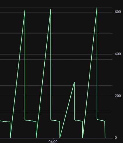

In my case I had to use step: end to achieve my desired result.
