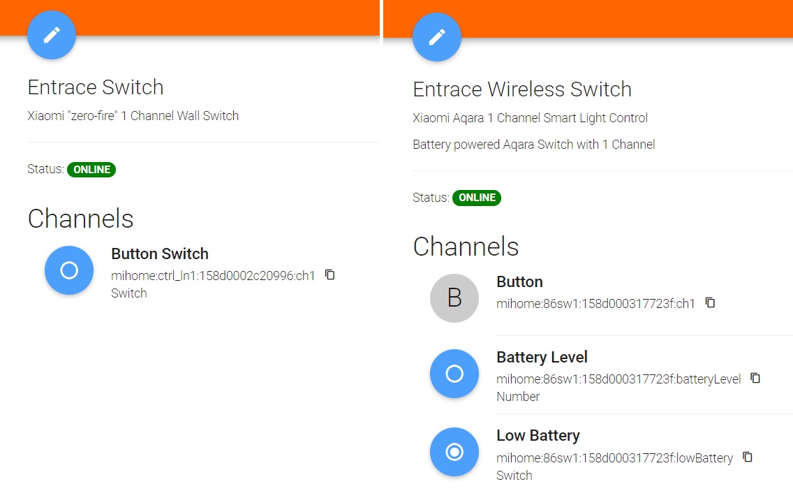

I noticed the following difference between Wall Switch and Wireless Switch:
The Button channel in the Wireless Switch is greyed out, while Wall Switch has a blue Switch channel.
