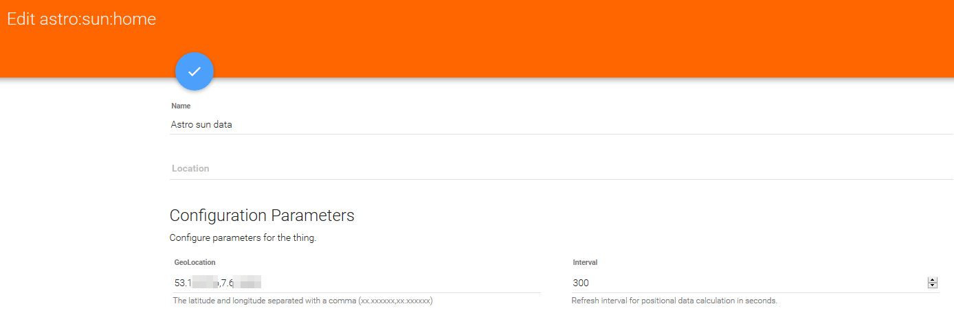

Wouldn’t it be more in line with OH2 (if this is the case) to have lat/long configured in a binding configuration section in Paper UI and have the binding automatically generate sun/moon things?
Ok, figured it out. Found out after much clicking you must set the lat/long by editing the individual thing info. I guess it works if you want to have this based on another location but it does seem kind of clunky.

The default channel after installation afaik is “astro:sun:local” and not “astro:sun:home”. Maybe that’s the problem? Have a look in the Paper UI -> Configuration -> Things.
The docs example is astro:sun:home, when you do it through PaperUI it’s astro:sun:local.
As long as both (things and channels) have the same wording it should be okay.
Hence my confusion… you just told me a few posts above that I didn’t need a thing file. Bit by the Paper UI/ non-Paper UI confusion bug.
That’s probably it then… I’m not at home to look right now but since I created the thing via Paper UI but copied the example from the binding readme I’m assuming the channel labeling is incorrect.
I get that (now), but for someone researching and not an expert in OH this can cause a lot of confusion. I think (unless there is a reason for it) it would make a lot more sense in the examples for the channels to be defined the same way in both methods.
