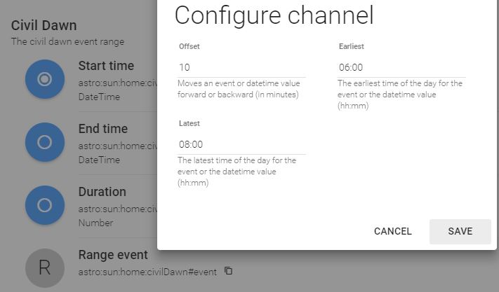

Astro-binding; trigger latest & earliest daylight/night
for a bit more confusion… :wink:
Type rangeEvent : civilDawn#event  [
            offset=10,
            earliest="06:00",
            latest="08:00"

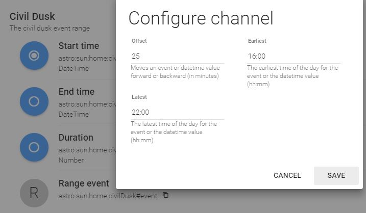

        Type rangeEvent : civilDusk#event  [
            offset=25,
            earliest="16:00",
            latest="22:00"
First event channel is used to open the roller shutters, second event channel is used to close them.
