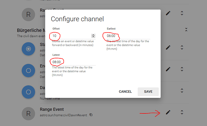

Please also take a look at Paper UI. You can see your thing and the channels.
My configuration (all text based)
Thing astro:sun:home "Sonne" @ "zuhause" [geolocation="49.91285478947813,8.661610652274543,130", interval=300] {
    Channels:
        Type rangeEvent : civilDawn#event  [
            offset=10,
            earliest="06:00",
            latest="08:00"

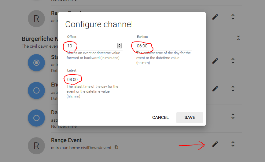

and the corresponding event channel in Paper UI:
As you can see, the values are correctly configured. But to be honest, I never checked if the event is triggered at the correct moment. :blush:

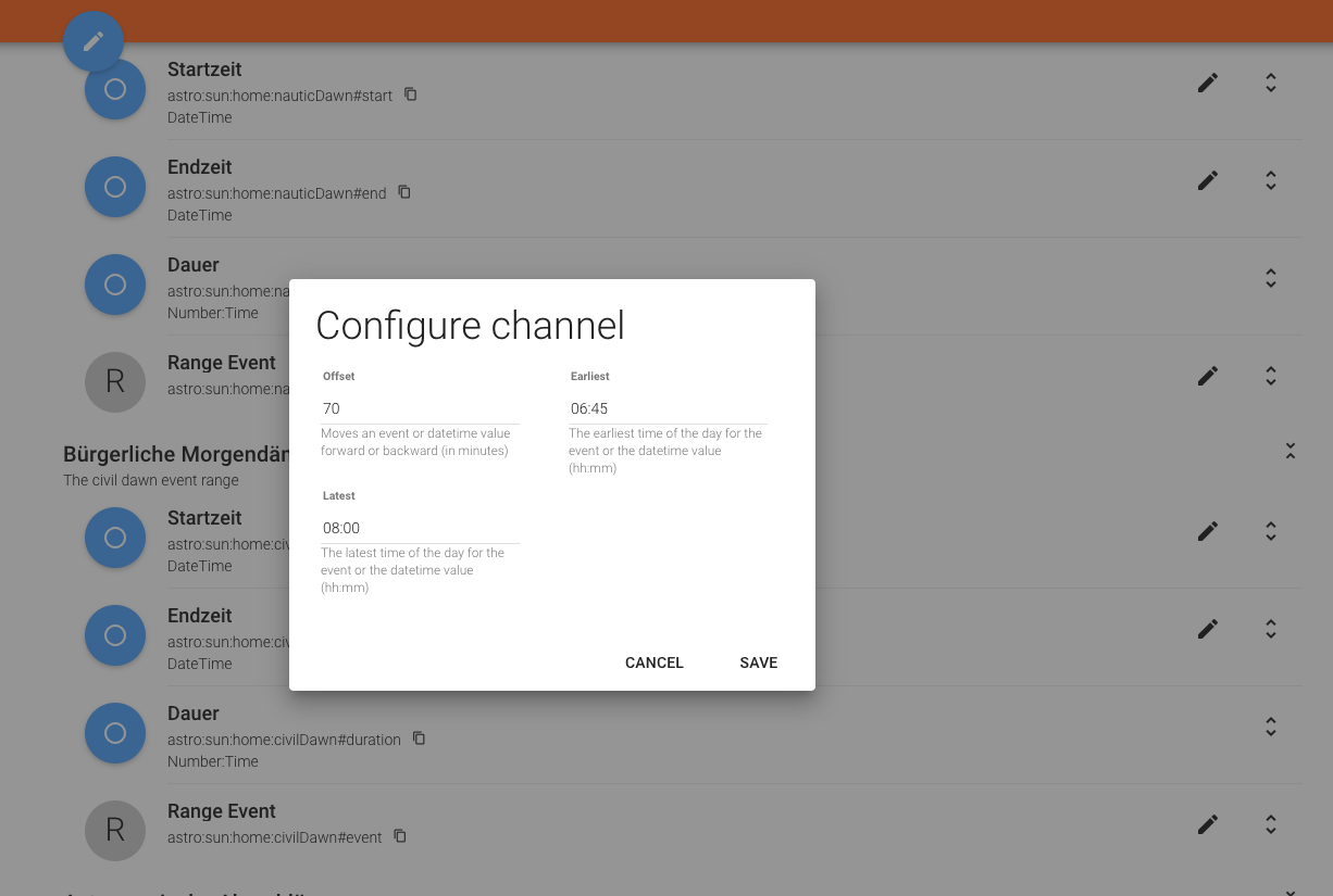

Additionally to show the corresponding event in Paper UI:
My rule “open blinds” fires at 6:13 am (today) which is way before the setting for “earliest”…
