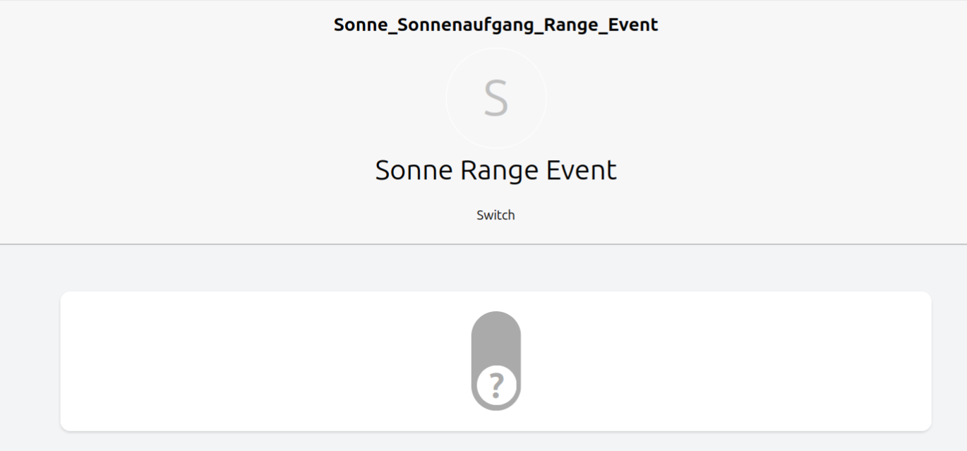

Astro Binding Triggers Stop Working

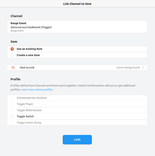

What the post that I linked suggests is linking with a profile. That’s what I did, but the item stays undefined after the channel triggered. Does it work for other people to link a Switch item via a profile to the, e.g., sunrise range trigger channel with a profile? I would have expected that the Switch item receives a state when sunrise starts (switching to ON) and that it switches to OFF when sunrise ends.
Which profile habe you configured?
The only one that is offered (i.e., not greyed out) in the GUI: Toggle Switch.
I get those three offered when trying to link a switch item to an Astro trigger channel on 5.1.0:
  • Generic Command
  • Generic Toggle Switch
  • Toggle Switch
The first two are configurable, the last one only toggles on PRESSED event.
Unfortunately the linked docs contain no „mapping“ to the names the UI displays.
Interesting. This is what it looks like for me, also on 5.1.0. No much choice here, and not much to configure…
I think I am starting to understand a bit better where the problems I am seeing are coming from, at least in some cases. My astro triggers remain erratic - sometimes it still seems that rules simply don’t get triggered at all. But for a few of the rules additional logging pointed me to an issue that explains some of my problems, one that’s more easy to pin-point.
