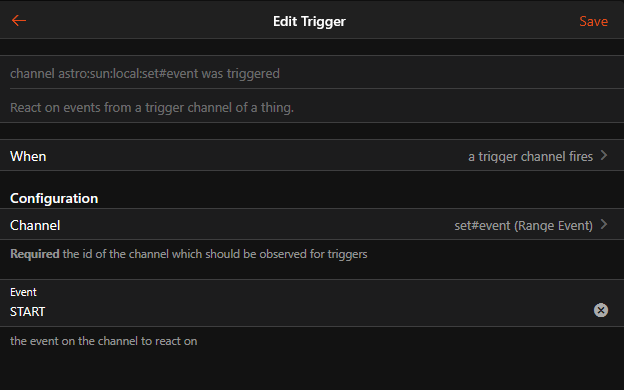

I’m trying to use the Astro binding to turn on a few rules, but it’s not working.
The idea is to have a time frame where Openhab checks the Lux values, and closes the blinds when it’s dark enough.
We had some dark clouds last winter that closed the blinds in the afternoon.
I’m hoping with the time slot from the Astro binding that won’t happen anymore :slight_smile:
I selected the channel trigger for sunset, and used START as the event.
There is a second rule where i use END as event to disable the rules again.
The rules are not enabled/disabled.
Should i use an Item instead of a trigger?
Thanks in advance for your help!
There’s more to this than you’ve shown here required to make this work.
You can make it work using the event triggers, but that’s probably not the best way. Trigers are not states. They are events. Your rule will run the instant that the set event starts (given the screen shot).
But what do you do with that? Do you set the state of an Item?
Based on your requirements you need to check the Lux values to decide when to close the blinds. And you want to add an additional condition to not close the blinds between certain times even if the Lux says it should.
Triggering a rule based on these times may help achieve that. But it depends on what you do with that event in that rule. Triggering your blinds rule isn’t going to be the one to trigger with this event.
So you have a start time and an end time where you don’t want the blinds rule rule to run.
