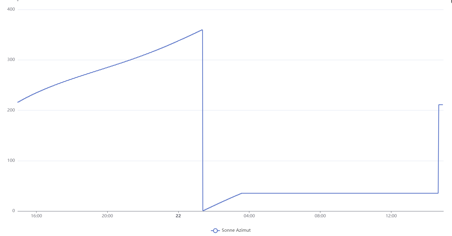

However, I use e.g. the Azimut or the Angle. And since the openHAB update, it sporadically stops to send updates:
At around 3:30, the Biding stopped sending new values. At around 14:40, I re-initialized the Thing. When I enabled it again, it sent the actual values, but then stopped again updating the values.
I do not see any issues regarding this binding in the log file.
When I disable the Thing, it looks like this:

Interesting is
2024-08-22 15:07:44.841 [INFO ] [o.internal.handler.AstroThingHandler] - Scheduled Positional job astro:sun:local every 300 seconds
But this Scheduler does not work anymore reliably.
After re-starting the openHAB service (not the Pi) it works again (at least for some time).
Any ideas how I can improve this situation?
