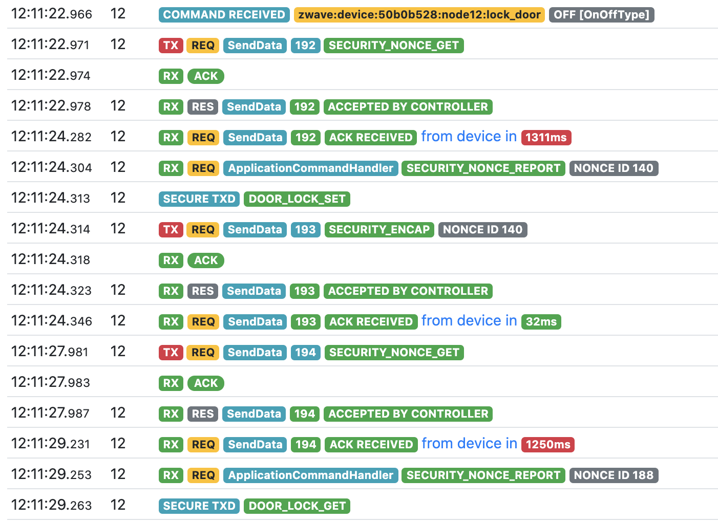

Looking at the log, we can see this is working ok -:

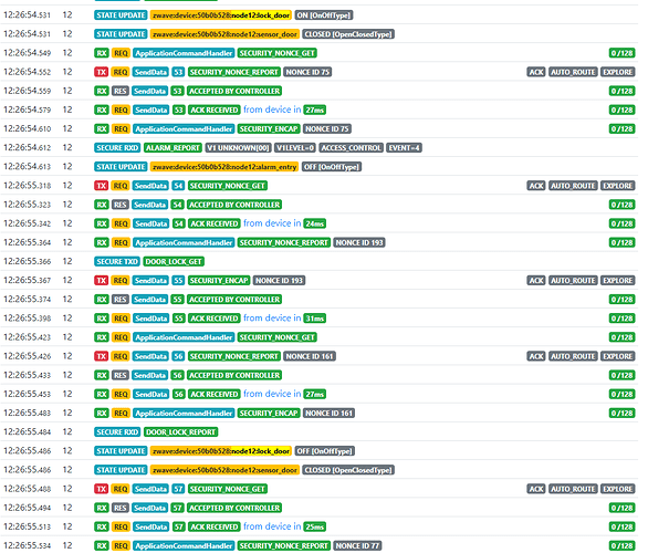

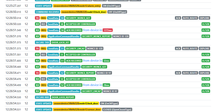

Does this show how it’s bouncing between lock/unlock? You can see the status update going to ON then back OFF after the command is received (slight overlap in the screenshots)
I’m not really sure what the lock is doing and it’s hard for me to comment on what is should do to be honest. It does change back to locked, but maybe that’s normal? Do you have autolocking enabled?
