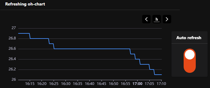

I like to use auto refresh charts, but sometimes the chart refeshes at a bad time: when I am looking in the past days or when I am zooming in.
So it is good to be able to temporarily disable the refreshing. Here is an example of the changed widget:

component: f7-card
  title: Refreshing oh-chart
  key: =(chartAutoRefresh==='ON')*(Math.random()+items.UI_Refresh_Timer.state) +
    (chartAutoRefresh==='OFF')*Math.random()
  default:
    - component: oh-chart
        label: Outside Temperature
        period: h
        grid:
          - component: oh-chart-grid
            config: {}
        xAxis:
          - component: oh-time-axis
              gridIndex: 0
        yAxis:
          - component: oh-value-axis
              gridIndex: 0
              scale: true
        series:
          - component: oh-time-series
              gridIndex: 0
              xAxisIndex: 0
              yAxisIndex: 0
              type: line
              item: Buiten_temperatuur
              animation: false
A new switch item ‘chartAutoRefresh’ is needed for this. In the page where the widget is used, a toggle card is added:
