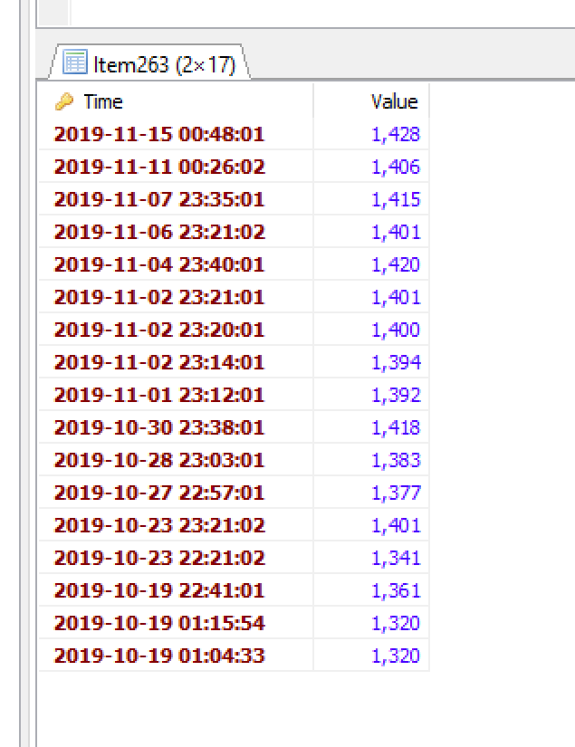

Data in the mysql table
So, if I go to a period where there is no data, it acts correctly, returns null. Makes sense.
If I go well into the data period, it works as expected.
If I straddle the latest two rows for the data it errors which I don’t feel is right.
I’ve read a number of the other posts which also have this error and can’t see any similarities.
Anything I am doing daft here or should this just be logged as a bug?
