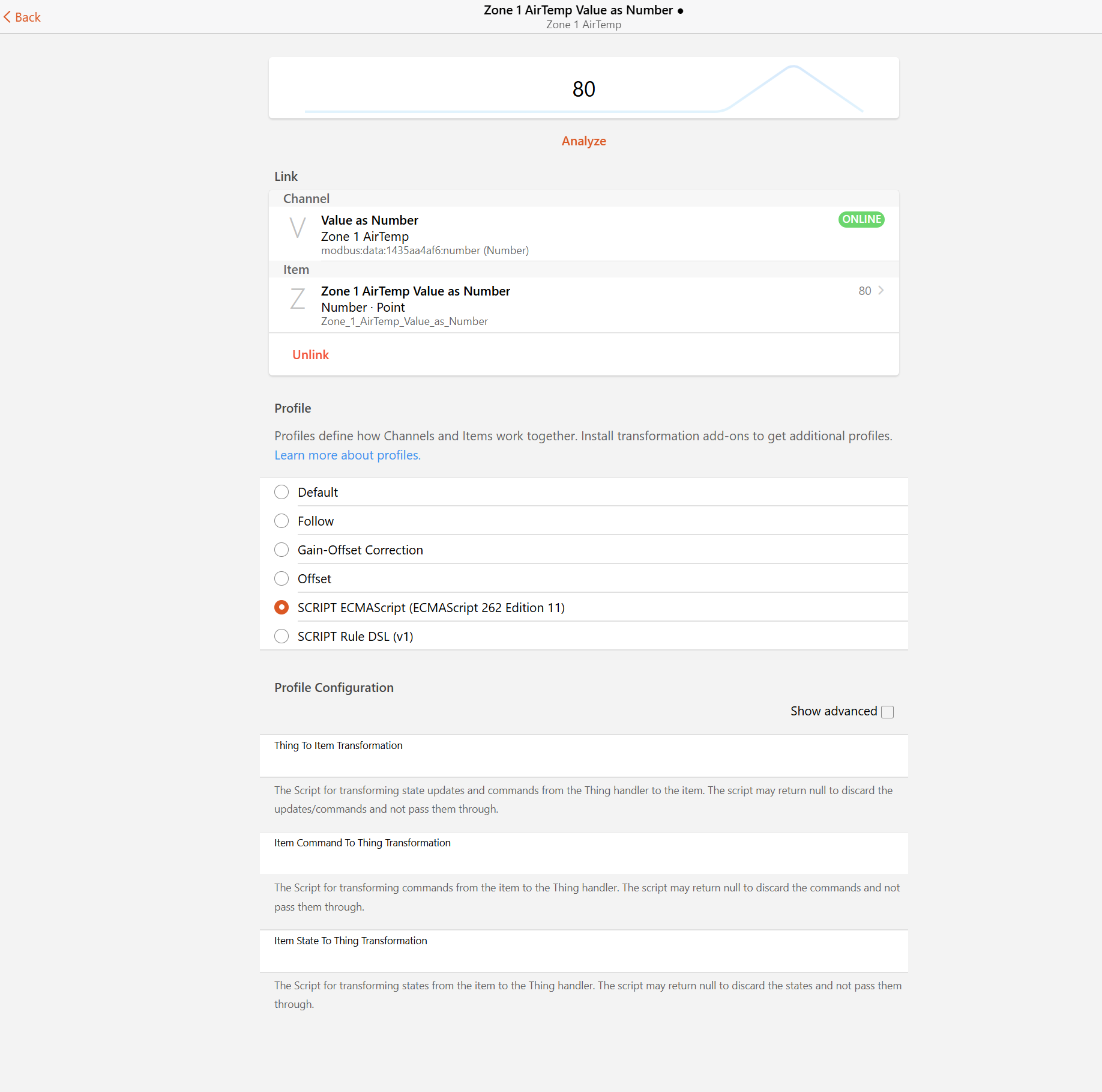

Does that script get entered in the “Thing to Item Transformation” box in the Item definition?
Played around with it a bit and I have in-memory persistence enabled for this Item but cut-and-paste your script and I get error logs for the return statement and can’t resolve item.this_item.numericState.
Need to read up on ECMA scripting.
Yes, entries you add in the Settings/Transformations menu will become available as a drop down item in the “Thing to Item Transformation” box.

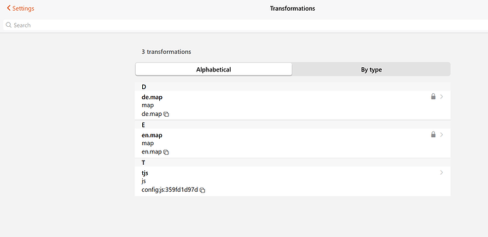

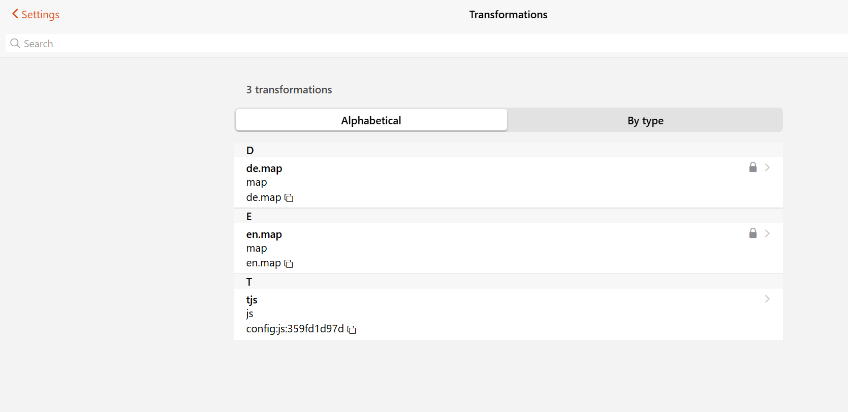

tjs.js isn’t the UID of the transformation. That would only be the case if this was the name of a file under $OH_CONF/transformations. The UID of that transformation is, according to the screen\shot, is config:359fd1d97d.
When creating an Item, rule, transformation or anything else, you should always repalce the randomly generated UID with something meaningful.
