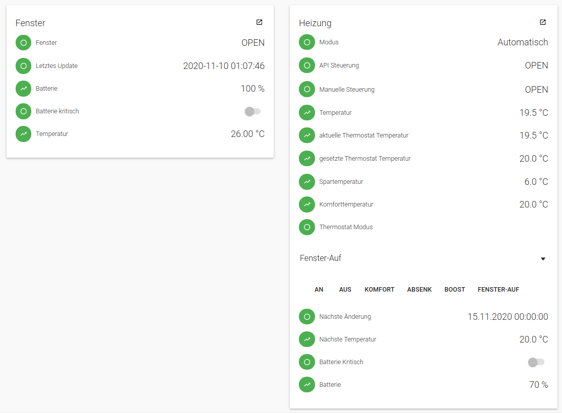

AVM Fritz! Binding does not recognize radiator mode "WINDOW_OPEN"
i figured it out by reading the sourcecode..
var actions = getActions("avmfritz", "avmfritz:FRITZ_DECT_301:fritz:bedroom-heater")
rule "Bedroom Heater Off"
    Item Bedroom_Window changed to OPEN
    actions.setWindowOpenMode(86400)
rule "Bedroom Heater On"
    Item Bedroom_Window changed to CLOSED
    actions.setWindowOpenMode(0)
rule "Bedroom Heater Force Off"
    Item Bedroom_Heater_radiator_mode changed
    if (Bedroom_Window.state == OPEN) {
this was painful!
i almost thought about ditching fritz dect things all together.. but this is kind of neat now.
