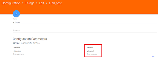

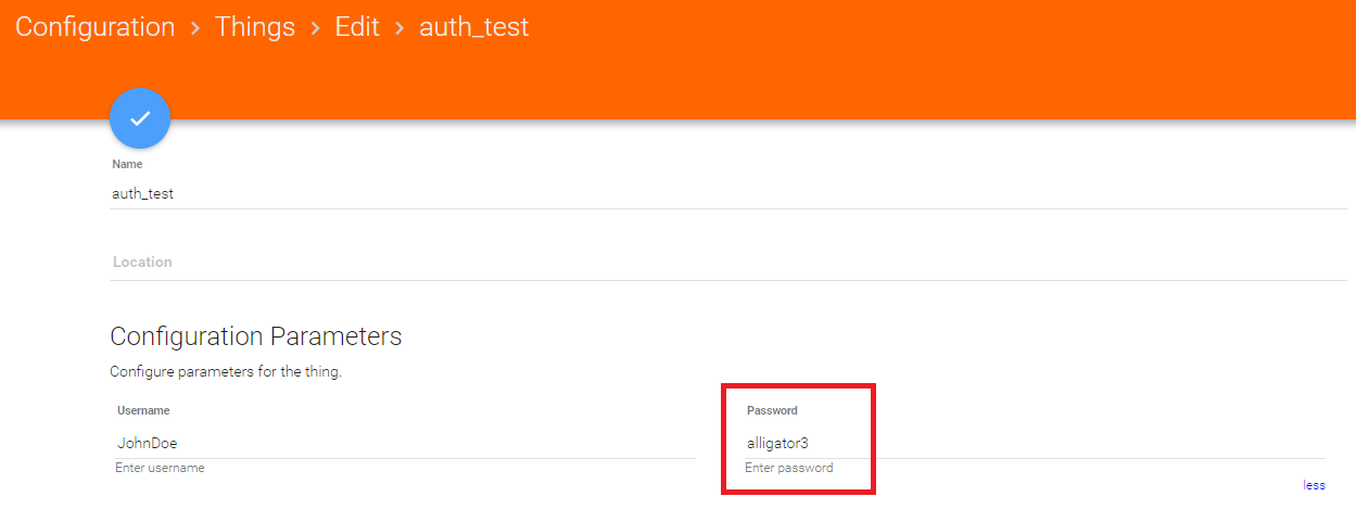

Yes, thank you. This works for the internal handling but the password is still displayed in plain text in the thing configuration.
Such changes would have to be made inside the parameter tag of the thing-types.xml? I am new to binding development and this is still a little confusing.
I believe it is hidden if you add:
<context>password</context>
to the parameter.
Perfect! That works. Thank you guys :slight_smile:
