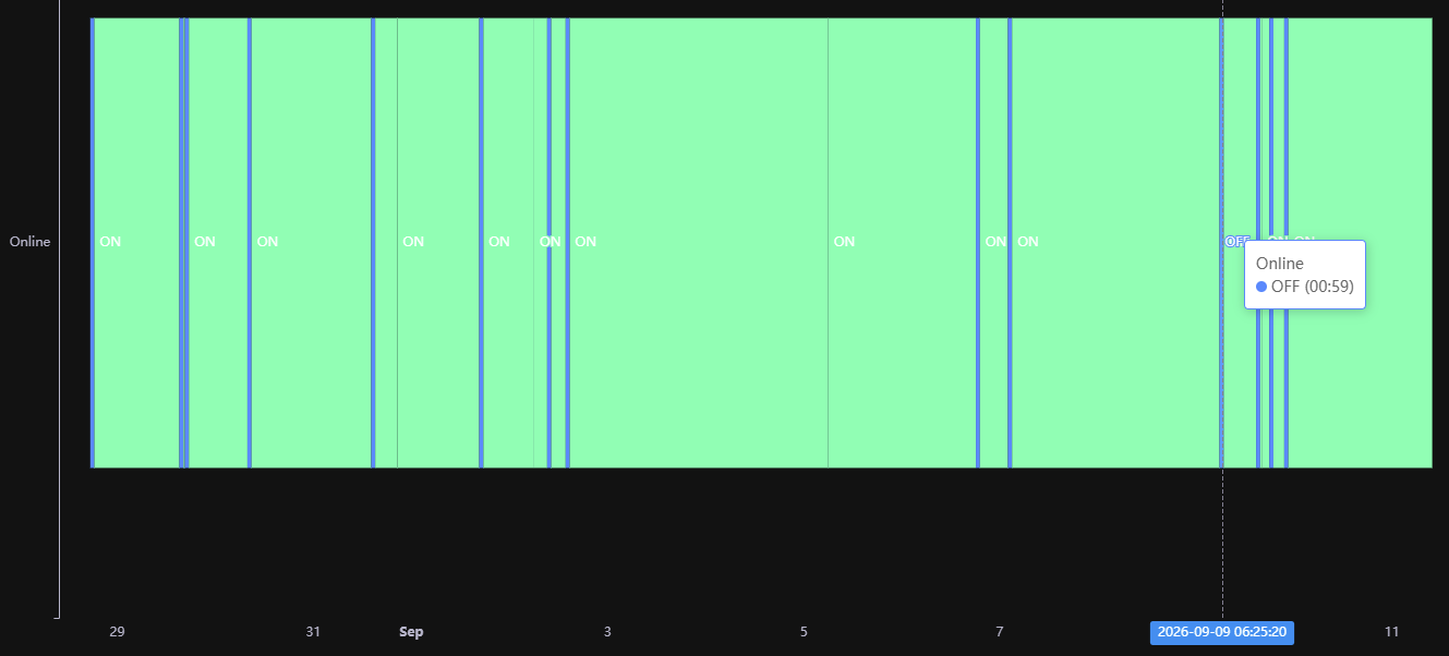

What I did a month ago: placed a (temporary) access point near the hot tub, which increased stability. I only have 2 weeks worth of persistence for this item, but before there was more “blue” intervals! :wink:
but still there’s the typical 00:59h dropouts. (network binding with ping on the wifi-module)
As an idea: I was able to eliminate those dropouts by disabling 5 GHz within the repeater.
