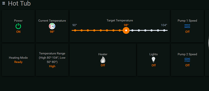

And just to give the complete content, here is my OH rule for the tub:
var lastAlert = now.minusMinutes(5) // set to five minutes ago so the Rule can run when OH first starts
var Number LoadingFor = 0
var Number NotLoadingFor = 0
var Number SwitchOffTries = 0
var Number SwitchOnTries = 0
rule "Init Balboa"
		System started
  postUpdate(BALBOA_OPERATIONMODE, "AUTO")
rule "HeatUpManually"
  Item BALBOA_MANUAL changed to ON or
  Item BALBOA_OPERATIONMODE received command
  logInfo("-18-balboa.R3", "Manual Heating On Received: " + BALBOA_OPERATIONMODE.state)
  if ((BALBOA_OPERATIONMODE.state == "AUTO") || (BALBOA_OPERATIONMODE.state == "ON"))
    logInfo("-18-balboa.R3", "Manual Heating On Received")
    if (BALBOA_TEMP_RANGE.state == "Low")
        executeCommandLine("/usr/bin/python3 /etc/openhab2/scripts/balboa.py temprange")
    if (BALBOA_SET_TEMP.state < 38.5)
      executeCommandLine("/usr/bin/python3 /etc/openhab2/scripts/balboa.py settemp 38.5")
rule "SwitchOffTubOverNight"
	//Every weekday at 14:00 hours
	Time cron "0 0 22 ? * * *" or
  Item BALBOA_OPERATIONMODE changed
  if((BALBOA_OPERATIONMODE.state == 'AUTO') || (BALBOA_OPERATIONMODE.state == 'OFF'))
    if (BALBOA_MANUAL.state == ON)
      BALBOA_MANUAL.postUpdate(OFF)
  if((BALBOA_OPERATIONMODE.state == 'AUTO') || (BALBOA_OPERATIONMODE.state == 'OFF')) {
    executeCommandLine("/usr/bin/python3 /etc/openhab2/scripts/balboa.py settemp 30");
  else
    executeCommandLine("/usr/bin/python3 /etc/openhab2/scripts/balboa.py settemp 38");
rule "HeatUpWhenEnoughPower"
	Time cron "*/30 * 09-15 ? * * *"
	//Item KebaPower changed or
  //Item PV_Meter changed
  if ((BALBOA_OPERATIONMODE.state == 'AUTO') || (BALBOA_OPERATIONMODE.state == 'ON'))
    var Number Available = -(PV_Meter.state as DecimalType)
    logInfo("-18-balboa.R3", "Available: " + Available.toString() )
    if (((Available > 2000) && (KebaPlugLocked.state == OFF)) || (Available > 3000))
			SwitchOnTries += 1;
			SwitchOffTries = 0;
      logInfo("-18-balboa.R3", "SwitchOn: " + SwitchOnTries);
    if (((Available < -1000) && (KebaPlugLocked.state == OFF)) || (Available < -100))
      if (BALBOA_MANUAL.state == ON) // No need to care if ON anyway
        logInfo("-18-balboa.R3", "SetTemp: 38")
      else
        SwitchOffTries += 1;
        SwitchOnTries = 0;
      logInfo("-18-balboa.R3", "SwitchOff: " + SwitchOffTries);
    if (SwitchOnTries >= 5) {
      if (BALBOA_SET_TEMP.state < 40)
        executeCommandLine("/usr/bin/python3 /etc/openhab2/scripts/balboa.py settemp 40")
        logInfo("-18-balboa.R3", "HeatUp: 40")
    if (SwitchOffTries >= 5) {
        if  (BALBOA_SET_TEMP.state > 38)
      else
        if  (BALBOA_SET_TEMP.state > 30) {
        logInfo("-18-balboa.R3", "SetTemp: 30")
	// update item to switch on light here
rule "NormalizeTemperature"
	Time cron "0 10 15-17 ? * * *"
      executeCommandLine("/usr/bin/python3 /etc/openhab2/scripts/balboa.py settemp 37")
      logInfo("-18-balboa.R3", "HeatUp: 38")
rule "Hot Tub: Parsing (SPARaw) JSON output to individual Items"
   Item SPARaw changed
logInfo("-18-balboa.R2", "### Hot Tub: Parsing (SPARaw) JSON output to individual Items ###")
   val String json = (SPARaw.state as StringType).toString
   gHotTub_Parse_json.members.forEach [ value |

I am using some of my PV output to load the tub over day (and prevent heating over night).
Thats awesome, thanks so much
When changing the heating mode, the status updates with either Ready or Rest, and I have now just spotted the temp range high or low, which is perfect.

First, thank you all so much for all the work that went into this script, I hope my small contributions help in some way to make this script the best it can. I’ve made some modifications to the script to make it work as I would like. I’m very new to Python, and programming in general.
I have a new Hot tub with Balboa Controller and Wifi. I am able to control nearly every function in OpenHab’s HabPanel thanks to this forum post and it’s contributors. Here are my updates to the Python Script, Rules, and Items. Things have not changed if your python script is called balboa.py.
How to use this version of balboa.py from CLI and Openhab HABPanel:
/usr/bin/python3 /etc/openhab2/scripts/balboa.py status //Prints status of defined variables from hottub. Unused in HABPanel
/usr/bin/python3 /etc/openhab2/scripts/balboa.py settemp 000 //Changes the Target Temperature of the hottub. Uses Item Balboa_Set_Temp in HABPanel on slider defined 90°-104°F
/usr/bin/python3 /etc/openhab2/scripts/balboa.py heatingmode //Toggles the heating mode from ‘Ready’ to ‘Rest’, and back. (My hottub only has the 2 options.) Uses Item Balboa_Heating_Mode in HABPanel as button with empty Command value/Action type. Check “Show the item’s state value” in the ‘Display’ Tab
/usr/bin/python3 /etc/openhab2/scripts/balboa.py temprange //Toggles the heating range from 50°-80°F (Low) or 80°-104°F (High). Uses Item Balboa_Temp_Range in HABPanel as button with empty Command value/Action type. Check “Show the item’s state value” in the ‘Display’ Tab
/usr/bin/python3 /etc/openhab2/scripts/balboa.py lights //Toggles the lights on and off. Uses Item Balboa_Lights in HABPanel as button with empty Command value/Action type. Check “Show the item’s state value” in the ‘Display’ Tab
/usr/bin/python3 /etc/openhab2/scripts/balboa.py pump1 (Off,Low,High) //Sets pump1 to the value of Off, Low or High. A null value will just toggle to the next speed in the series. Be aware that the hottub operating system will start pump1 automatically for heating and filtering, and anytime pump2 is activated. This may override your selection. Uses Item Balboa_Pump1 in HABPanel as a selection with a Comma-separated list of Off,Low,High.
/usr/bin/python3 /etc/openhab2/scripts/balboa.py pump2 (Off,Low,High) //Same as pump1
except pump2!!
/usr/bin/python3 /etc/openhab2/scripts/balboa.py settime (hh mm) //Set the time on the hottub controller. Must be sent as 24hr clock in the format hh mm. I don’t yet have a HABPanel widget for this one.
I also use some Dummy HABPanel widgets for Items Balboa_Temp (Current Temperature) and Balboa_Heating (Heating On/Off)

HABPanel- The “Power” widget is a Wemo switch connected to a contactor. Works well to cut power to the whole system.
