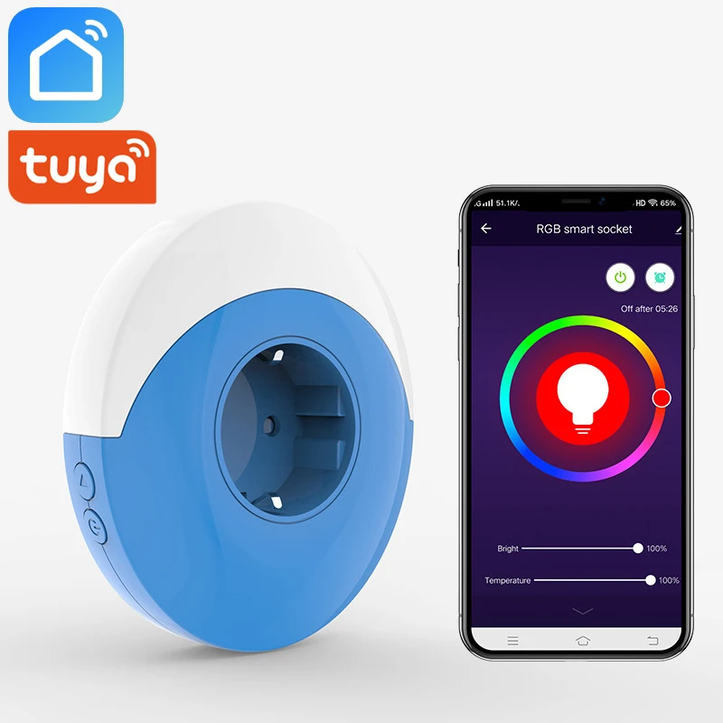

Sure please find the product link below. Please not its tuya but I installed tasmotta on it
and tasmotta template which I created after understanding how to create the template. I am beginer in home automation
{"NAME":"MyRoom","GPIO":[39,255,157,255,38,37,0,0,10,17,0,21,255],"FLAG":0,"BASE":18}
