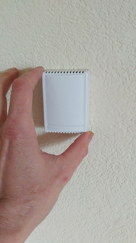

I use a MySensors MQTT Ethernet gateway.
It is placed in a central location in the house and picks up every nodes without problems even without the big antenna.
