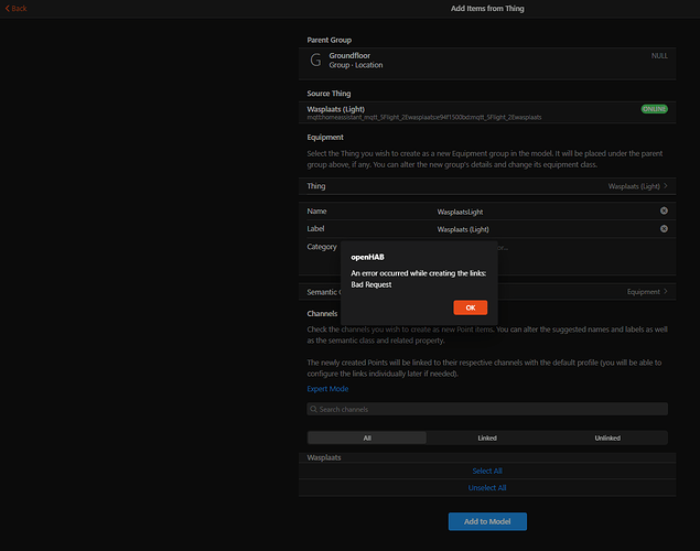

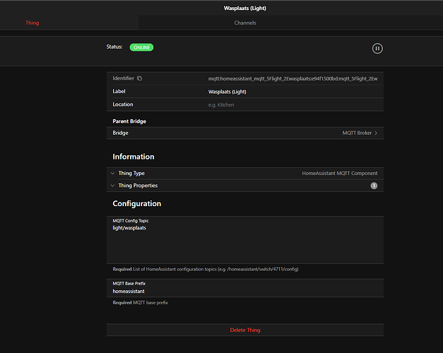

Hey @micware , i’m back from vacation, want to start working on it again, but still stuckj on channels
Openhab found a lot of mqtt lights and i see them all in inbox (44 items)
I added one as a test from inbox, looks like:
Next, added a model (groundfloor) , but now i’m stuck
when i “create equipment from thing” or "create points from thing’, i always get error…
What am i missing?
What i do see in log, when i goto model => create points from thing, i see this in log:
2022-07-26 17:44:47.491 [WARN ] [ab.binding.mqtt.generic.ChannelState] - Command '{"state": "OFF"}' from channel 'mqtt:homeassistant_mqtt_5Flight_2Ewasplaats:e94f1500bd:mqtt_5Flight_2Ewasplaats:mqtt_5Flight_2Ewasplaats#light' not supported by type 'ColorValue': {"state": "OFF"} is not a valid string syntax
2022-07-26 17:47:02.634 [WARN ] [ab.binding.mqtt.generic.ChannelState] - Command '{"state": "OFF"}' from channel 'mqtt:homeassistant_mqtt_5Flight_2Ewasplaats:e94f1500bd:mqtt_5Flight_2Ewasplaats:mqtt_5Flight_2Ewasplaats#light' not supported by type 'ColorValue': {"state": "OFF"} is not a valid string syntax
2022-07-26 17:50:24.625 [WARN ] [ab.binding.mqtt.generic.ChannelState] - Command '{"state": "OFF"}' from channel 'mqtt:homeassistant_mqtt_5Flight_2Ewasplaats:e94f1500bd:mqtt_5Flight_2Ewasplaats:mqtt_5Flight_2Ewasplaats#light' not supported by type 'ColorValue': {"state": "OFF"} is not a valid string syntax
seems its indeed related to colorvalue, i now added a thing from inbox, like a switch instead of light, without colorvalue, that seems to work without an issue
so its related indeed to colorvalue, but how to fix?
