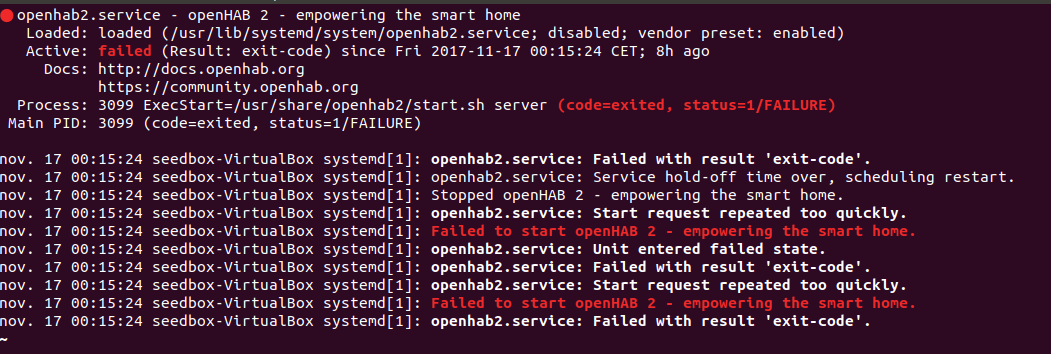

It seemed like the service was trying to start, but it just never finished. The guide says it could take up to 15 minutes, but I am sure I waited for an hour. Then I decided to restart the machine, and if I check the status of the service with the status command, it says Loaded, but inactive. If I try to start the service it fails.
This is my first time using Linux as well, so I am not quite sure were to look for the problem, so I would appreciate any advice.
Thanks.

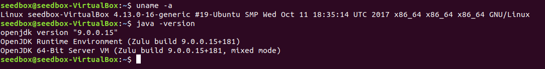

Try to downgrade to Zulu JDK 8 to see if this solves the issue.
If yes, please report back with the following info:
uname -a
java -version
and the exact openHAB 2.x build (2.0 or 2.1 or 2.2 snapshot #)
so we can see which combo is problematic and update the docs
http://docs.openhab.org/installation/index.html#prerequisites
Thanks for the input guys.
I tried running your commands. This is the Java install:
Running the journalctl command, I get a line that says “Java 1.8 or higher required, aborting launch”. So it seems my installed Java version does not work?
Hi again. I see that it is like you said, the guide says to not use Java 9 yet. So, a Linux question then. How do I downgrade Java?
