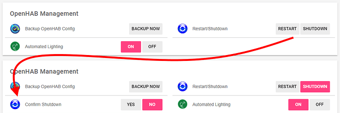

Hi @rpwong
I went down a similar path as yourself figuring out how to get a reboot+shutdown to work, though I used buttons on the sitemap (in a sub frame of the site map). I used the visibility option on the sitemap to make a Yes/No dialogue appear/disappear (as necessary) to confirm the action for reboot or shutdown.
Untitled
Items
String 		Restart_Shutdown 		"Restart/Shutdown"
Switch		Restart_confirm			"Confirm Restart"
Switch 		Shutdown_confirm		"Confirm Shutdown"
Sitemap
Switch item=Restart_Shutdown	mappings=["1"="Restart", "2"="Shutdown"]
Switch item=Restart_confirm		mappings=["ON"="Yes","OFF"="No"]	visibility=[Restart_Shutdown=="1"]
Switch item=Shutdown_confirm	mappings=["ON"="Yes","OFF"="No"]	visibility=[Restart_Shutdown=="2"]
Rules
//** Restart OpenHab Server **
rule "Restart OpenHab Server"
		Item Restart_confirm received command
		switch (receivedCommand) {
			case ON : { logInfo("Restart", *** Restart Server - Sent from UI ***", "\n") Restart_Shutdown.postUpdate(3) Restart_confirm.postUpdate(OFF) executeCommandLine("sudo@@reboot", 10000) }
			case OFF : { Restart_Shutdown.postUpdate("3") }
//** Shutdown OpenHab Server **
rule "Shutdown OpenHab Server"
		Item Shutdown_confirm received command
			case ON : { logInfo("Shutdown", *** Shutdown Server - Sent from UI ***", "\n") Restart_Shutdown.postUpdate(3) Shutdown_confirm.postUpdate(OFF) executeCommandLine("sudo@@shutdown", 10000) }
Thought it worth throwing this into this post.
