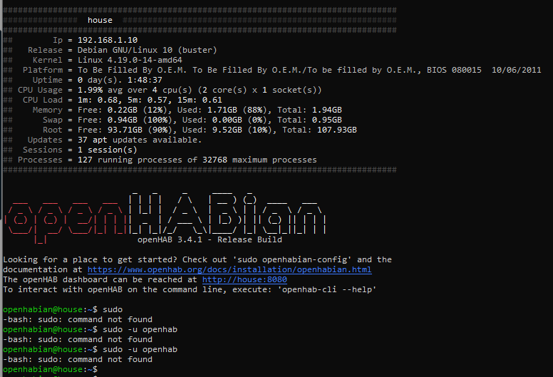

Following this guide i can’t seem to get it to reboot.
    val results = executeCommandLine(Duration.ofSeconds(1),"reboot")
    logInfo("Flag_System", "executeCommandLine output " + results)
I get the following response and no reboot : executeCommandLine output Failed to set wall message, ignoring: Interactive authentication required.
I was getting a null response, but have removed the ‘sudo’ as that does not seem to be on the system. Sorry my linux knowledge is very limited. Running x86 openHABian on version 3.4.1. Any help would be greatly appreciated.
Thanks.
If it’s openHABian than sudo is definitely on the system and it is definitely required to run a command like reboot.
the error is saying “interactive authentication required” which means either sudo or reboot is asking a question and requiring you to answer it. The first time a user runs sudo there is a dialog that you need to accept by typing “yes” . Run the command from the command line, but remember that OH runs as user openhab, not your login user. So you first need to become that user.
sudo -u openhab
sudo reboot
Maybe this is the issue, as when I type sudo it returns ‘command not found’. Looking over my notes from a few years back it looks like I installed Debian and then using git downloaded the openhabian-setup.sh to install etc.
Do you think installing sudo be the first step to get this working? thanks
It’s a catch-22. You can’t install anything unless you are root and you can’t run a command as root without sudo. So either your path is messed up and /usr/bin isn’t in your path, or sudo is not installed in which case you need to rebuild this machine from scratch. You can’t do anything meaningful without sudo.
It had to be there at some point because openHABian requires it to be there too, so the problem is likely your path which openHABian should have configured properly too. So over all this is a relatively sick machine.
Ok thanks. Ahhh! don’t have time to rebuild this sick machine now and it runs a LOT of stuff in the house. So looks like a rebuild is one of them jobs when i have more time!
I’ll do an image backup for now and see if I can install/reconfigure sudo. Thanks for the info.
You can tell if it’s just a path problem by trying to run the full command using the full path.
/usr/bin/sudo
It had to be there at some point.
If it’s just a path problem, you probably just need to edit a config file. You’ll want to make sure that /usr/bin is in the PATH defined by profile.
And you probably want to use the full paths anyway in the executeCommandLine.
I checked /usr/bin/sudo and it was not there. I have now installed sudo and added sudo back to the executeCommandLine and it’s working!
Not sure why sudo was not there, my linux knowledge is minimal but I’m sure it’s not something I would have removed. I normally log in as root, so could I have installed openHABian-setup.sh via the root account? Anyway, it’s working now, thanks for all your help.
How without sudo? This is a Debian OS?
Sudo is now installed after typing ‘apt get install sudo’.
Yes, running Debian 10 buster, then installed openhab with the openHABian sh. Was unable to use the openHABian image as it’s a x86 machine
I shouldn’t have let you do that. Your login user must be root or something. And if that’s the case, you are running as root therefore you don’t need to use sudo perhaps?
Ultimately, if you had to install sudo in the first place this is a very non-standard installation.configuration so it’s going to be very challenging to support in the future and on this forum.
Ok thanks for your help. I’ll rebuild it when I get the time.
