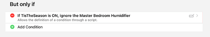

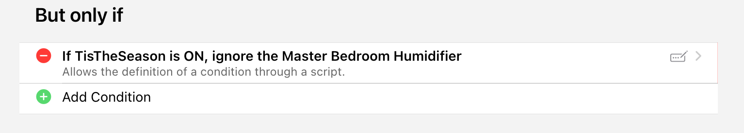

Then add a Script Condition to each that tests for whether it’s OK to run that rule now. You wouldn’t even need code for this and can do it all using the built in UI conditions. But if you were to write it as code it’d look something like:
time.toZDT().isBetweenTimes('6:00 AM', '9:00 AM')
&& items.getItem['Study_ZW089_vDoor'].state == 'CLOSED'
Though again, I’d probably just use the UI conditions.
