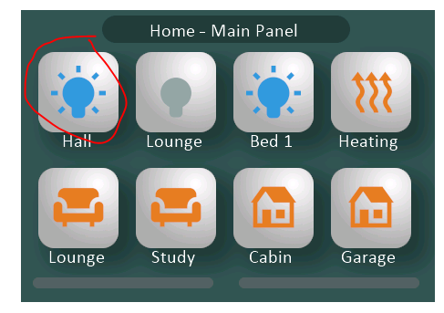

I’ve got the NSPanel working nicely now over MQTT, but I am still pondering the best way to keep things in sync with OH items.
The panel can send and receive lots of different messages relating to openhab items. The panel itself knows nothing of OH or it’s items.
Pressing this button simply sends
{"button":{"pid":10,"bid":1,"state":1}}
