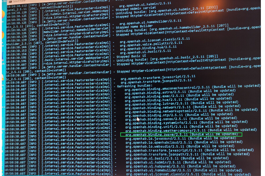

Anyone know how to disable, automatic updates of bindings. This has caused me problems far too many times. I downloaded and installed OH 2.5.2 roughly a year ago. Not sure how | when this problem started, but I can’t figure out how to stop it. Some have suggest that I turned this feature on, and other that I must be running update scripts.
Installing the MQTT binding this morning, and watching the logs, is when this was caught.
This cannot be stopped. It’s due to the way karaf decides what shall be installed. It started when we started micro-versions (2.5.x).

Only if you install a new binding. As long as you don’t touch the bindings, everything stays where it is.
But: if you have 2.5.2 installed and then later (when 2.5.11 is available) install a binding that was not installed before, you‘ll most probably get 2.5.11 also on the installed bindings.
