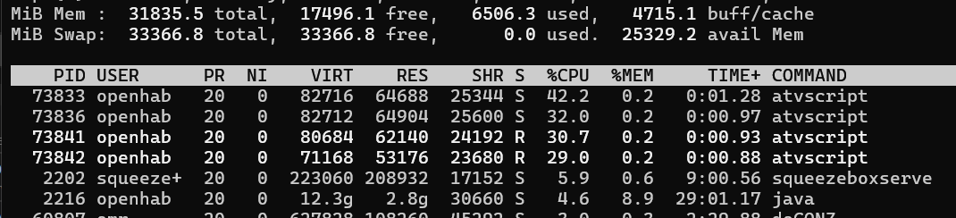

Does this works ?!
Any chance of running the threads a little ā€˜nicer’?
Seem to use a lot of CPU:
Wow, that doesn’t seem normal, although the field that’s actually interesting is the time… none of them seem to have used much more than 1 second of CPU time. Are your atvscript instances exiting right after starting?
For example, here’s my openhab instance, and you can see that my 2 atvscript instances have very modest usage:

You can use ps to see when the process was started.
All pids are just active for a few seconds, so yes, all exit, but the PC gets warm, so the CPU usage is real.
Just tried a reboot. Ends up the same:

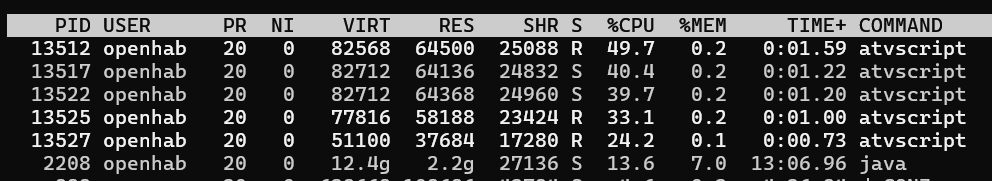

I’d like to chime in with @OMR - i’m seeing the same thing. I have not changed hardware, but updated my linux, and temps are spiking. I am running 3 ATV’s all 4K gen2/3, and there is alot of cpu usage with each instance, i get around 15C extra temperature on my cpu, so running all 3 things, my cpu is around 100C, but disabling the 3 things, i get steady temps around 55C.
That’s interesting. My setup is obviously different and I’m not seeing this behavior. I don’t have a good answer for why this is happening yet, but am trying to come up with a solution. I will note that the error ā€œmetadata is blockedā€ is coming from pyatv, so it’s not a binding bug per se. Hopefully the answer is just slowing the requests down a bit.
The increase in temperature is due to the constant exceptions killing and restarting the processes.
