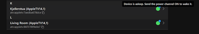

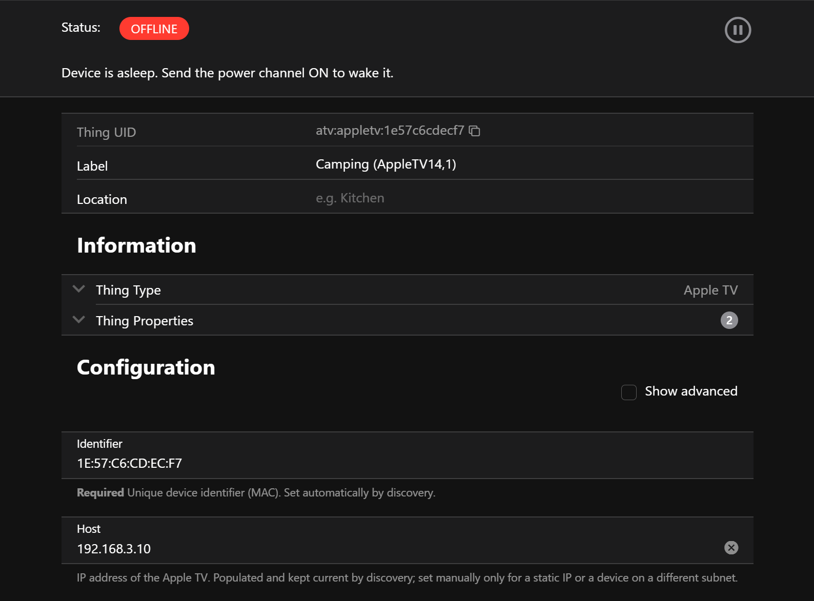

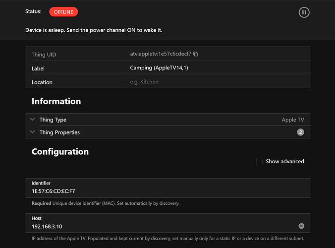

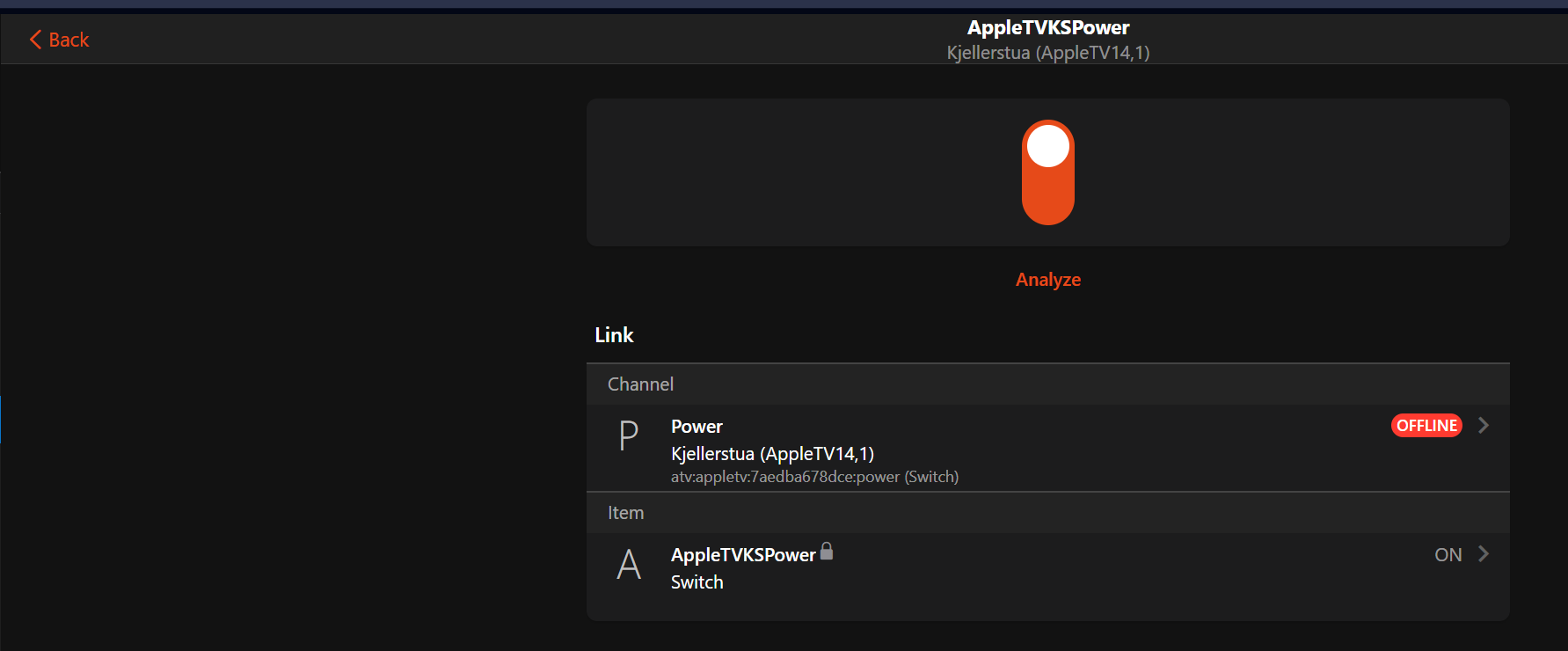

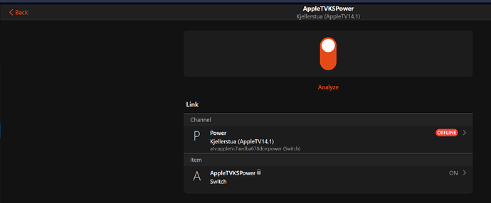

Binding for Apple-TV
Deep sleeping through the night …
But pingable:
omr@rpi4lydhus:~ $ ping 192.168.3.10
PING 192.168.3.10 (192.168.3.10) 56(84) bytes of data.
64 bytes from 192.168.3.10: icmp_seq=1 ttl=64 time=1.57 ms
64 bytes from 192.168.3.10: icmp_seq=2 ttl=64 time=0.397 ms
64 bytes from 192.168.3.10: icmp_seq=3 ttl=64 time=0.404 ms
64 bytes from 192.168.3.10: icmp_seq=4 ttl=64 time=0.383 ms
64 bytes from 192.168.3.10: icmp_seq=5 ttl=64 time=0.330 ms
64 bytes from 192.168.3.10: icmp_seq=6 ttl=64 time=0.257 ms
64 bytes from 192.168.3.10: icmp_seq=7 ttl=64 time=0.306 ms

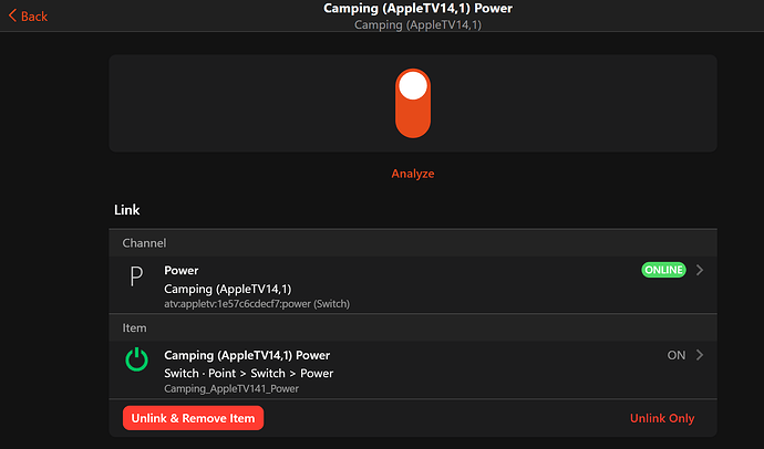

So I guess ONLINE is a better option.
But, I had to try twice turning the ATV ON using the Power channel.
First time nothing happened and the GUI button went back to OFF.
Second time a few seconds later, it responded:

Does this fact impact out next test?
I had to turn the Power channel ON 3 times now to wake it. GUI button goes down to OFF after some time, but did not wait the full minute to see if it woke up.
Nit: When the Power channel do come on in this menu, the Thing status remains OFFLINE until I refresh the WEB browser:
I have move location and now have 2 ATV on my LAN, so keep that in mind when reading logs.
My log is much more talkative now with 2 ATVs and an Airplay Receiver, but was this what you were looking for? Only grep hit on ‘poll’ after more than 70min OFF.

Verified OK.
Now stays ONLINE when OFF.

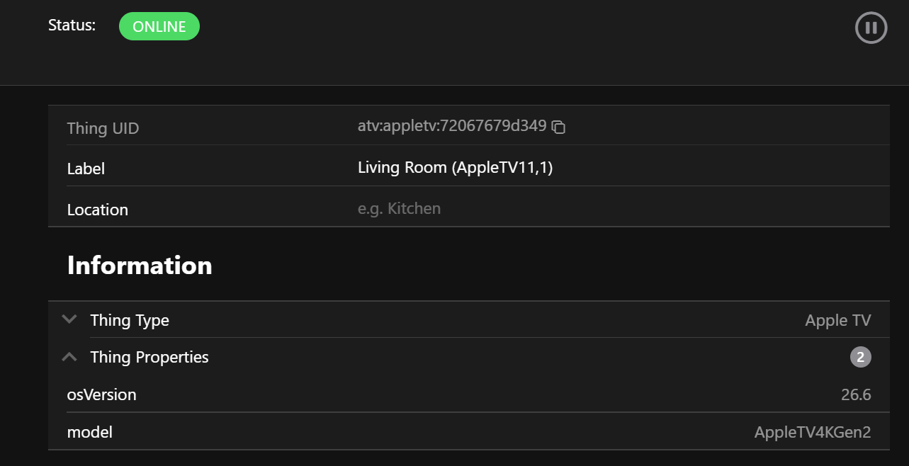

ICYMI: 26.6 seems fine …

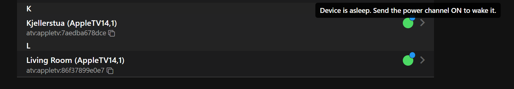

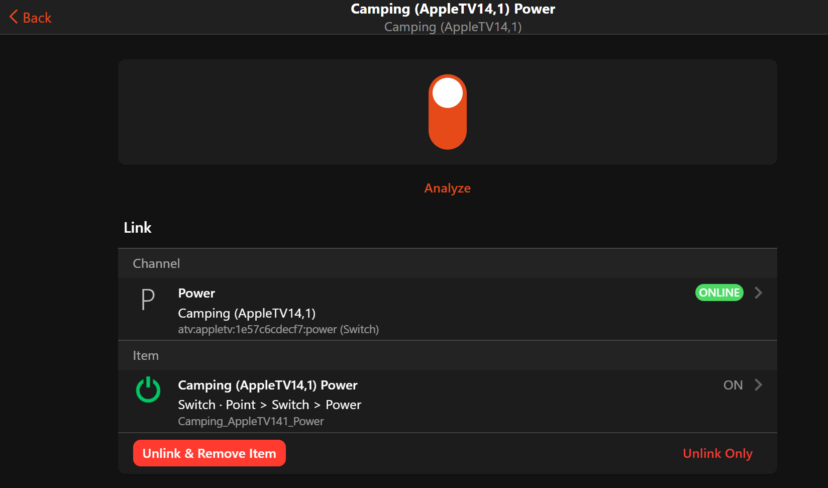

And new Thing status:
