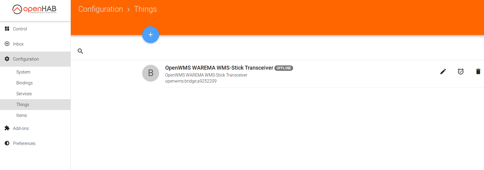

But PaperUI show me the status OFFLINE. No scan with remote control (Warema Basic, 1002953) is possible.
I try it with a direct connection via USB with the same problem (OFFLINE). The stick works with Warema Studio or toolkit.@rainer300 can you support me plz? thanks

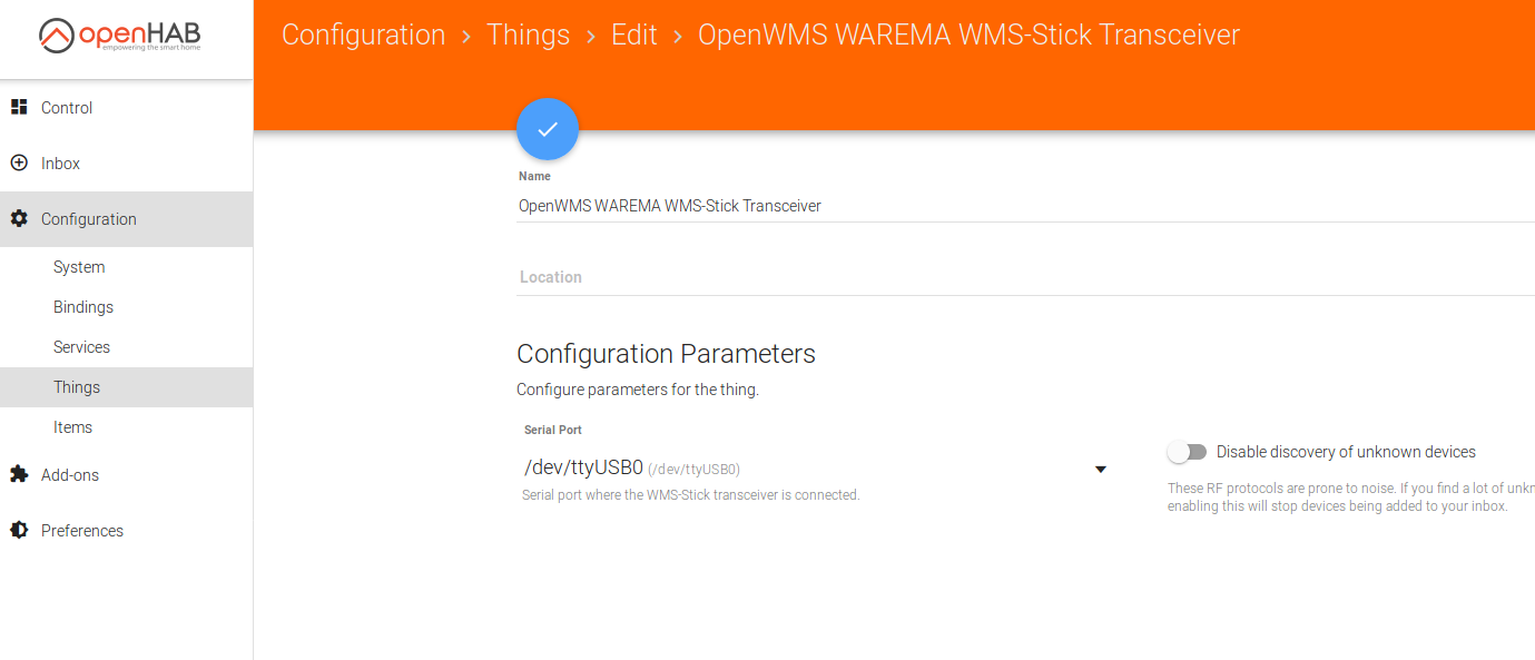

Hi hj8i5,
if the stick is directly connected to the Raspberry on which openhab runs, no bridge over TCP/IP (socat) is needed.
Please try to use the thing “OpenWMS WAREMA WMS-Stick Transceiver” and enter the port directly (e.g. /dev/ttyS0).
Hi @rainer300,
I try both variants with the same problem. I create new Thing “OpenWMS WAREMA WMS-Stick Transceiver” and select the correct port /dev/ttyUSB0 which I a found in the /var/log/messages.

In Paper UI the device is marked as OFFLINE and I have the following log entry.
2019-07-31 14:11:39.595 [ERROR] [openwms.handler.OpenWMSBridgeHandler] - Connection to OpenWMS transceiver failed

When I try to add the Warema WMS-Stick Transceiver and configure the port (/dev/ttyUSB2 in my case) I get the same error than @hj8i5 above: UnsupportedCommOperationException: Invalid Parameter
2020-01-09 22:56:35.318 [ERROR] [openwms.handler.OpenWMSBridgeHandler] - Connection to OpenWMS transceiver failed

"First of all you have to configure an Warema USB-Stick. This device has to be added manually to OpenHab and is represented by an OpenWMS bridge.
You just have to set the right serial port. If everything is running fine you should see the Current firmware version: of your USB-Stick in the properties of your bridge."
In the inbox “Search for things”, OpenWMS Binding, WMS Stick Transceiver USB selected and “/dev/ttyUSB0” selected and confirmed with a click on the blue tick.
https://abload.de/img/wmssticketj4c.jpg
The result is as depressing as the first time I tried it. The stick has the status “OFFLINE”.
