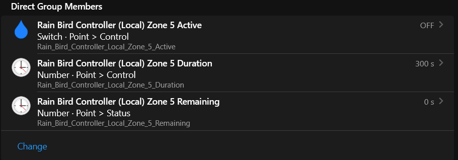

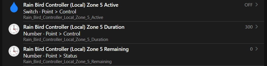

  1. Create Items from Channels for each Zone
  2. Add Metadata for HomeKit
    • Zone X Active = value: Valve.ActiveStatus,Valve.InUseStatus
    • Zone X Duration = value: Valve.Duration
    • Zone X Remaining = value: Valve.RemainingDuration
  3. Head to Settings - Items and click “+”
  4. Name ex: RainBird_Zone_5
    Lable: <name shown in HomeApp>
    Type: Group
    Semantic Equipment: Irrigation
  5. Fill Group Members

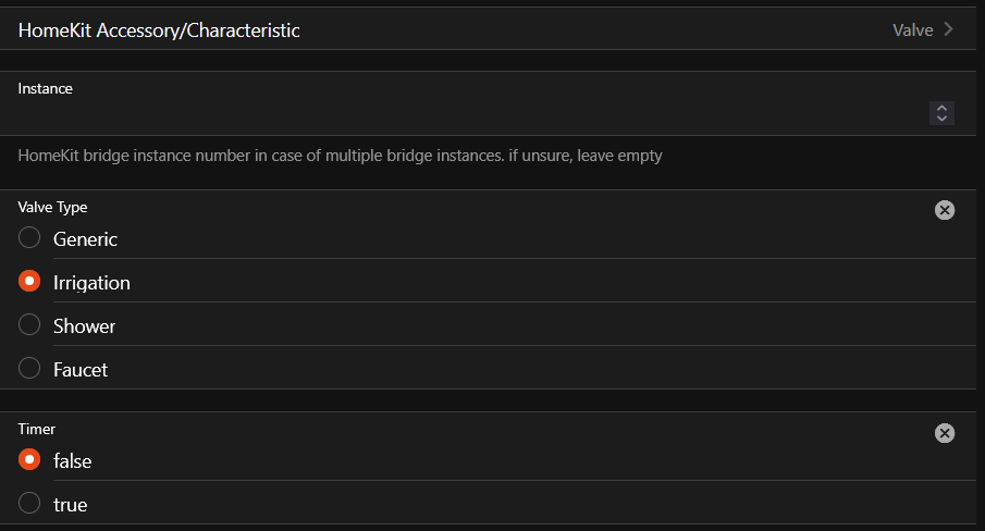

  6. Add Metadata - IMPORTANT: choose valve for HomeKit Accessory/Characteristic and Valve Type will pop-up
  7. Fill Group HomeKit Characteristics Mapping with your configurated items.

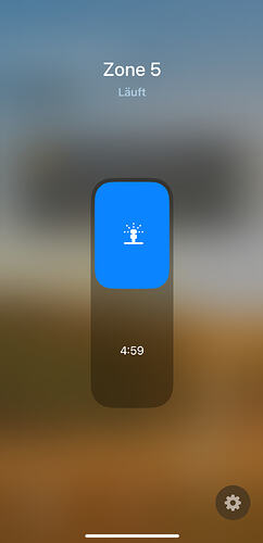

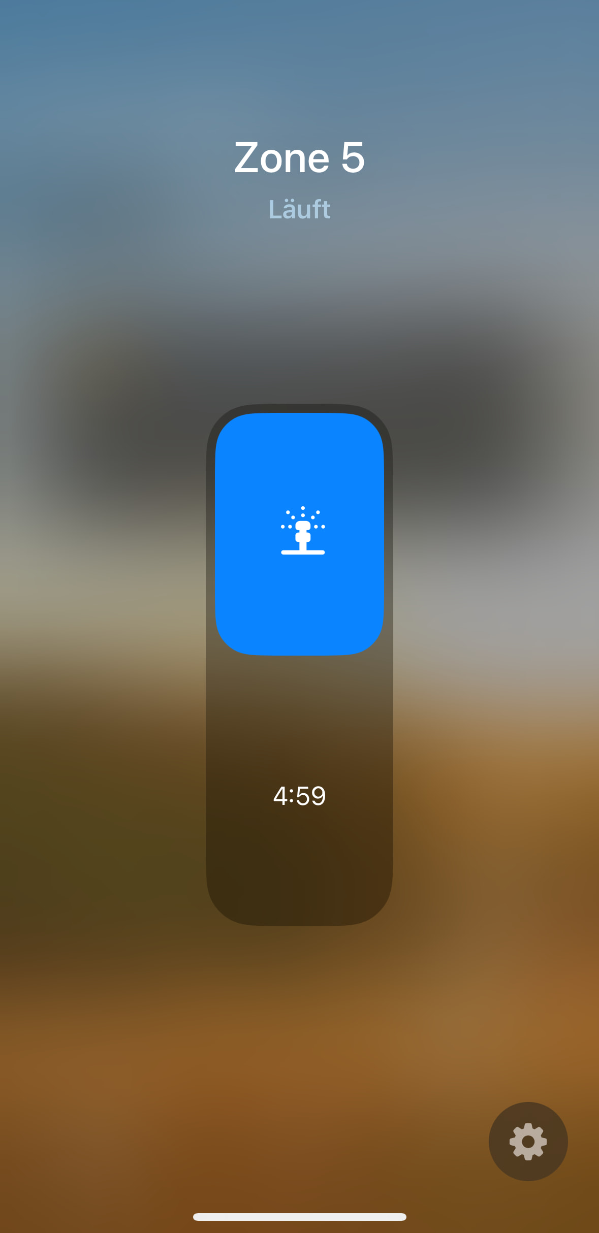

Note: HomeKit has some limitations when it comes to countdown for remaining duration. Also HomeKit knows 5 minute steps while OH “confuses” it when enter 60sec. but it still works.

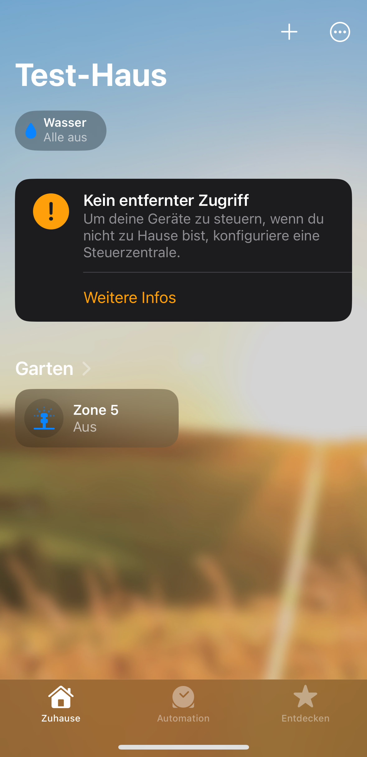

Result:
ENJOY!
