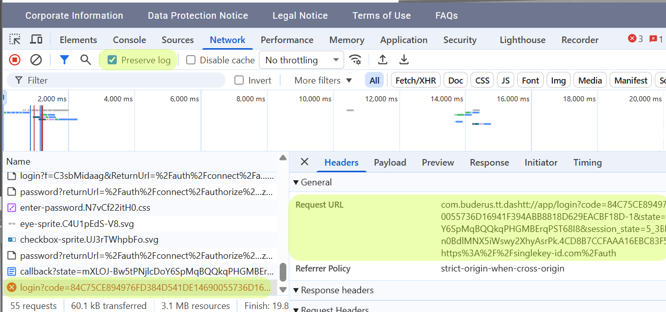

    • After init copy the http url in your browser to authenticate (Pic 1)

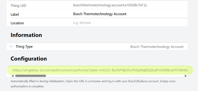

    • Fetch from Chrome/Edge development tools the request URL (Pic 2) and paste it into config Authorization Redirect URL

Pic 1
Pic 2
