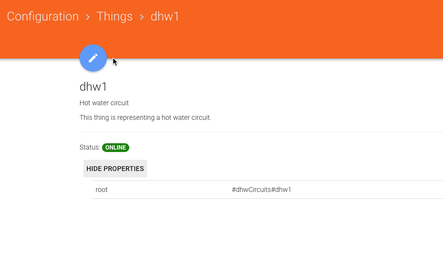

I have just noticed another problem. It seem that I cannot edit values in “hc1 switch program” to modify my heating profile.
My current heating profile is:
activeSwitchProgram: Eigen1
These values are not editable:
hc1-switchprogram_weekday: Mo
hc1_switchprogram_nbrCycles: 1.00
hc1_switchprogram_cycle: 1.00
hc1_switchprogram_day: 370.00
hc1_switchprogram_night: 1230.00
Is there something missing or a secret option to modify the heating program?
this is relevant to the multi-device support. You have to delete all things und detect them from new.
The device UID is missing and so it is not working.

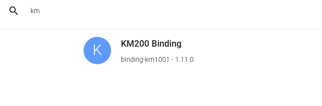

I played yesterday around getting KM200 work. No luck so far.

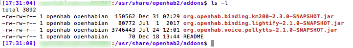

I first installed the 2 days old “km200-2.3.0-SNAPSHOT.jar3”, this one was not loading the hot water channels.
Removed the 2.3.0 from the add-ons folder and tried the existing 1.11.0 from paper ui, this one was not loading any Things
Uninstalled the 1.11.0 in paper ui and dropped the 2.2.0 from the thread above, this one was detecting wrong ip (ip in the name was ok , ip in the parameters was wrong. After changing the ip in the parameters, the binding was still not loading any Thing.
Removed the 2.2.0 and dropped 2.3.0 from above. Now this one is not Loading any thing accept the Gateway, which stays uninitialised.
All the time I have a valid km200.cfg file in the services, with ip address and private key entry
I have feeling running circles. I have seen some http-timeouts, but also exceptions thrown.
I would greatly appreciate a 1,2,3,4… step instruction how I could start from scratch, without reinstalling my RaspberryMatic instance.
Once I have such an instruction, I will supply all the needed log output to nail down the problems.
btw. It seems that the 2.2.0 snapshot binding did not make it into the official 2.2 release? true?

The configuration for the binding in openhab2 is directly in the paper UI. You don’t have to use the config file.
Where did you put the jar file? Directory?
seems correct…
Put a empty km200.cfg file in the /etc/openhab2/services directory. (touch /etc/openhab2/services/km200.cfg"
Is the binding appearing in the PaperUI?
I fixed an problem there in last version. Did you really use the last one? Download it again pls.
Did you configure the secure parameter in the PaperUI?
