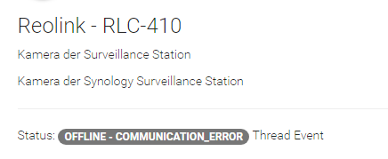

As it’s the Bridge error, please check whether your Bridge’s refresh rate is moderate, try to unlink the HomeMode channel from the Bridge or set its refresh rate to 0. Which version are you using?
OK. I unlinked the “Home Mode” Channel and now I’v set the refresh rate also to 0 (before it was 5 Sec.). I’m using the latest version (v32-alpha).
It is not the bridge making trouble… in most of the cases the Camera Thing is going offline.
It happend again some minutes ago. The Logfile does not contain any hint… it just starts repeating this line every 5 Seconds:
2019-01-06 15:55:13.327 [ERROR] [tation.internal.thread.SynoApiThread] - DeviceId: 9; Thread: Camera; Handler gone offline
Hi people! I’ve just published a new version with reworked HttpClient handling, which should greatly reduce overall thread count and perhaps fix other thread related issues. Please check release notes for further details:
@monnimeter
For using but static URI all refresh rates (Thing and Bridge) can be turned off. This static Item should be populated on openHAB start and be available in your sitemap. In every case, please unlink every channel you’re not using, as this too will disable their respective threads.
Please check the latest version too, it could also address your issue.

Hi @Pavion.
The new version (V.0.33-a) of your binding is running now for 2 days without any issue.
Great work, thank you much!
