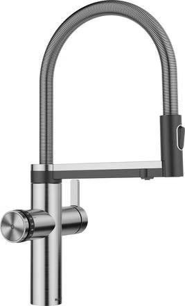

BLANCO CHOICE.All in openHAB: an ESP32 BLE-to-MQTT gateway
The BLANCO CHOICE.All is a drinking water system under the sink: filtered still, medium and sparkling water, plus boiling water, from one tap. It talks to exactly one thing: the BLANCO UNIT App, over Bluetooth Low Energy. No cloud, no API, no binding, and nothing for openHAB to bind to.

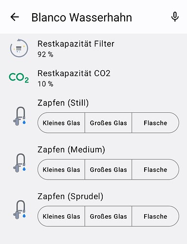

So I put an ESP32 next to it that speaks BLE to the unit and MQTT to openHAB. Filter and CO2 levels become Items, and the sitemap gets nine buttons for the combinations of glass size and carbonation my family actually uses.
(My own installation runs in German, hence the labels in the screenshot. The examples below are in English.)

Step 5: The sitemap, without a single rule
This is the part I like. The dispense command is a small JSON document:
{ "amount": 200, "intensity": 1 }
amount is millilitres (50–2000), intensity is 1 still, 2 medium, 3 sparkling. Since the String Item passes its command straight through to the MQTT topic, the JSON can live in the sitemap mappings. No rule builds it, no transformation is involved:
// sitemaps/home.sitemap
Text item=Blanco_CO2Rest label="Blanco faucet []" staticIcon="faucet_kitchen" {
    Default item=Blanco_FilterRest staticIcon="cleaning"
    Default item=Blanco_CO2Rest
    Switch item=Blanco_Dispense staticIcon="faucet_kitchen" label="Dispense (still) []"     mappings=['{"amount":200,"intensity":1}'="Small glass", '{"amount":300,"intensity":1}'="Large glass", '{"amount":1000,"intensity":1}'="Bottle"]
    Switch item=Blanco_Dispense staticIcon="faucet_kitchen" label="Dispense (medium) []"    mappings=['{"amount":200,"intensity":2}'="Small glass", '{"amount":300,"intensity":2}'="Large glass", '{"amount":1000,"intensity":2}'="Bottle"]
    Switch item=Blanco_Dispense staticIcon="faucet_kitchen" label="Dispense (sparkling) []" mappings=['{"amount":200,"intensity":3}'="Small glass", '{"amount":300,"intensity":3}'="Large glass", '{"amount":1000,"intensity":3}'="Bottle"]
Note the single quotes around each mapping value: the JSON contains double quotes, so the mapping has to be quoted the other way round. Three intensities times three sizes gives the nine buttons in the screenshot.
