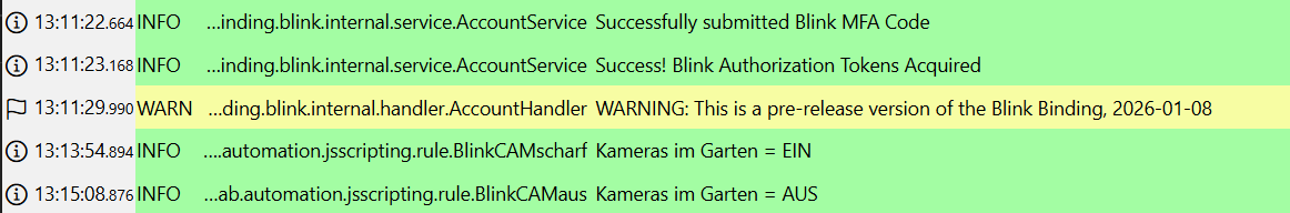

Sorry, I forgot to enter the MFA Code into the Thing “Blink Konto”.
Now I tested more in detail and the Blink Binding works!!!
@dashrb Thank you very much!!!

In the version provided by you all looks totally fine on my end:
Screenshot 2026-01-11 165400
