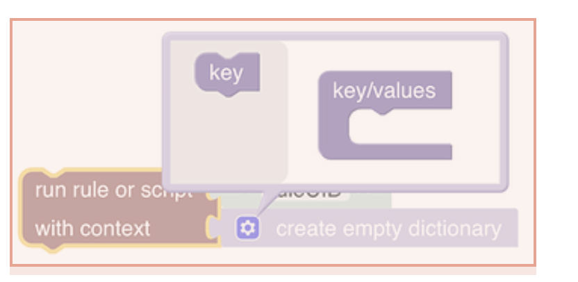

I am trying to add a dictionary (with just one key/value pair), effectively passing a parameter into a script which will be called from multiple places. My first experiment took me here:
Very close, but I can’t drag the “Hello” into the value position of the dictionary - it jumps back again whenever I try. From what I have read in the [excellent] documentation, it should work.

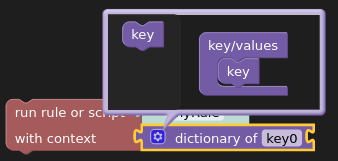

I just ran into this issue. I eventually replaced the whole violet coloured block with the last block from the Lists menu, to which we can attach a text block. Just remove any unneeded lines (I think it starts with three by default).
It is exactly right how you did it. You have to replace the block with the real one. There is a mention of that situation in the ‘Extending Blockly’ thread ( I am away which is why it is currently hard for me to point you to the right entry).

Parameters can be provided by adding a “dictionary” of key / value pairs to the block but can also be left empty if not necessary. The dictionary block can be found openhab blockly “lists” section where you can find more information on how to use it.
It’s that second sentence which seems important in this case, and at the time I didn’t understand that this was a MUST. I will edit the wording a little to try to make it a little clearer.
I’ve made some modifications to that section in the documentation. I have also replaced the screenshot that accompanied it as I realised that was the main reason for my confusion - it had the gear icon expanded which suggested you could add keys here, but that doesn’t work (at least not with the text and variable blocks I tried).

Can you please put the picture into it like I depicted it
but replace it with the new dictionary one before which then has a different color.
I intentionally wanted to show the cog’s popup there. You wording now makes it clear that it has to replaced.

will tentatively solve this problem - since the cog icon (“mutations”) don’t work with so-called “shadow” blocks then as an exception this makes it into a real block in the toolbox.
