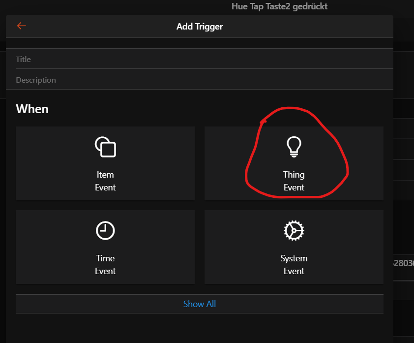

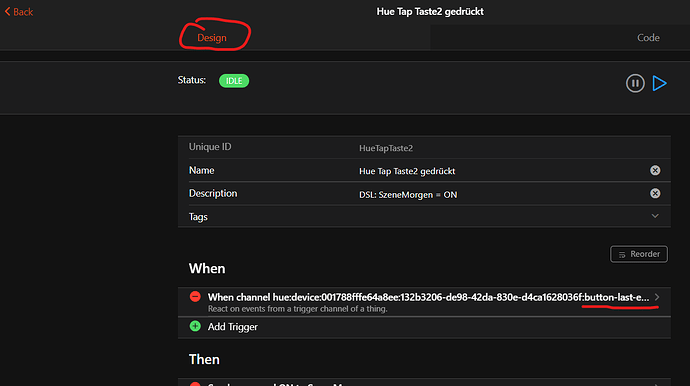

Hi @cdstaley, the “Hue Tap Switch” does not do “item state changes” but provide “events” which are not automatically stored in items. First you need to find out the values which a “event” provides.
rule configuration:

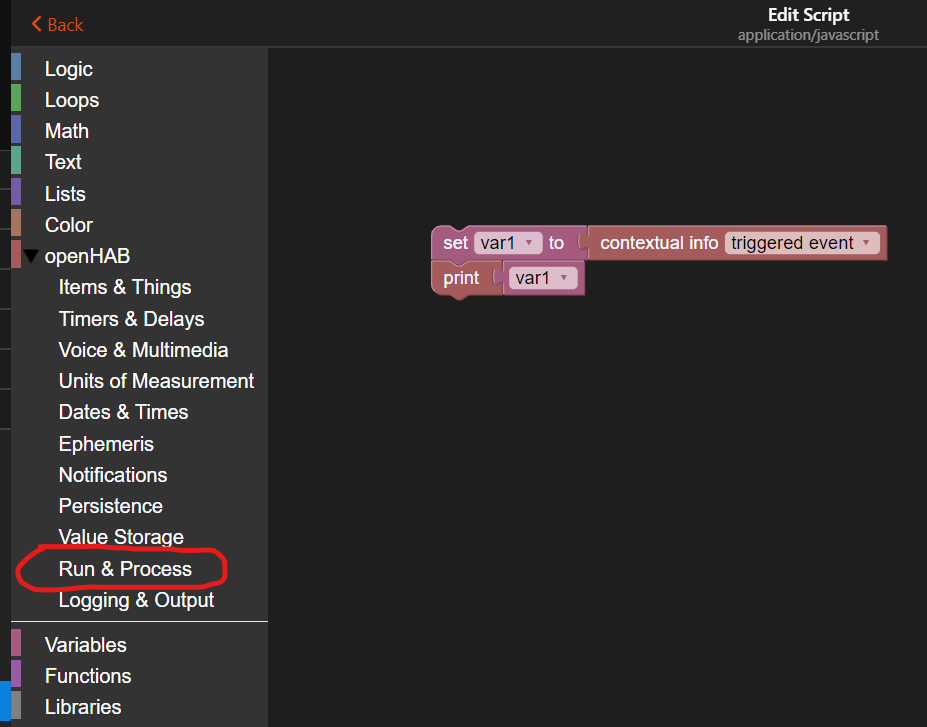

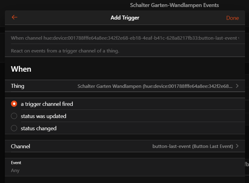

to find out the “event” values leave the “Event” field in the rule empty and enter the following blockly commands into the “THEN” area of the rule (this rule prints the event values into the log, when you press all the keys of the switch).

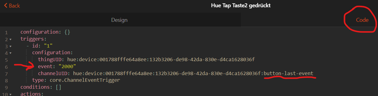

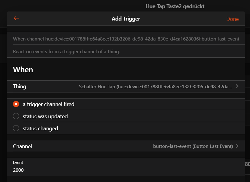

After you found the provided “event” values you can start to modify your rule for every key pressed (example for key2 pressed):
