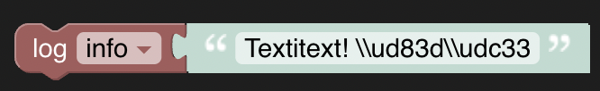

results into
logger.info('Textitext! \\\\ud83d\\\\udc33');
thus, blockly is escaping backslashes because it doesn’t understand unicode escape sequences.

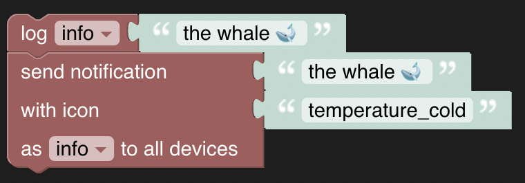

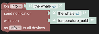

However, what you can do is just copy and paste the real (whale) character into the string and it works:
(I don’t use telegram, so I sent myself a notification via openHAB and I received the whale on my mobile)
