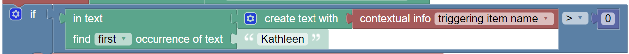

After migrating to openHAB 4, I find that the “contextual info” block has been rejected by the text block. If I had a “create text” block, it then works.

The OH 4 version of the code is with or without the “create text with” block? I’m guessing it’s with and you said above that works, right?
What code is generated without the “create text with” block?
The OH 4 is with the “create text with” block. It won’t allow me to attach the “contextual info” block to the “in text” block w/o first attaching an additional block, the “create text with” block.

I finally found the cause
I have lately changed the block types to be more accurate.
Actually the triggering item name is not the item string but the item type (internally called “oh_item” as type). So the triggering item name is a oh_item and therefore not just a string. The change was needed in other places to detect the oh_item better to evaluate and generate the right code where people would not care to either add the real oh_itemtype (as returned by getItem) or the oh_item (when picking an item). This allows me in OH4 to be much more forgiving on other places.
Unfortunately the in text block is blockly standard, otherwise I could make it more forgiving to oh_item as text. So, yes, that seems to be breaking (which I definitely tried to avoid as much as possible over the last months!) but it think it is worth it here.
