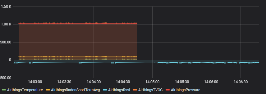

I’ve some issues with the generic bluetooth binding with OH 2.5.11. I have a Windows setup, and using BlueGiga. I’ve added Airthings Wave Plus. This works to begin with but stops to work after a while. I see that the item receives more updates than the refreshinterval (600). Why, can it be related to that somehow?
See this screenshot from Grafana:
