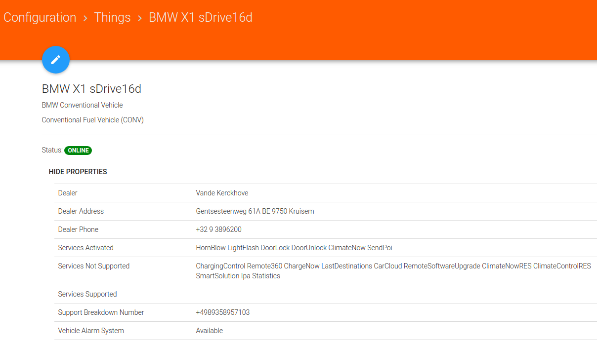

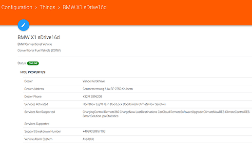

Hi @brononius Ben,
I’m using this binding too (and i’m very happy with it). The functions last trip, destinations, checkcontrol aren’t working for me either because it is not supported by my car or the service is not active in my BMW connected drive account.
Maybe checkcontrol should work, but I haven’t had an active check control message since I use this binding so I’m not sure about that.
In Paper UI you can find some more information of the functions that should (and won’t) work.
Go to Paper UI → Configuration → Things → [your car] (for me it is BMW 318i) → show properties
And look at ‘Services Activated’ and ‘Services Not Supported’.
Excellent.
So easy to see what should be working. :wink:
