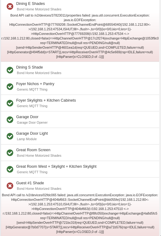

That revision is looking better. I still get some errors for a couple shades when I restart OH2. I don’t see ERROR in the logs, but HABmin indicates that there were some initialization errors:
Sorry about the readability of that screen capture, my primary monitor died this morning so I had to fall back from UHD to HD, which left the typefaces I use looking pretty marginal.
I have uploaded logs from suuccessful discovery through several OH2 restarts.
bondhome.log (764.1 KB)
[Edit: I replaced the screen capture with one that I think may be more readable.]

Statuses of my Bond things after restarting OH:
bondhome:bondBridge:BondHub (Type=Bridge, Status=OFFLINE (COMMUNICATION_ERROR): Unable get Bond bridge version via API, Label=Bond Home Bridge, Bridge=null)
bondhome:bondFan:BondHub:1e516d36 (Type=Thing, Status=ONLINE, Label=Guest 1 Ceiling Fan, Bridge=bondhome:bondBridge:BondHub)
bondhome:bondFan:BondHub:1f7b46ee (Type=Thing, Status=OFFLINE (CONFIGURATION_ERROR): Bond API call to /v2/devices/1f7b46ee failed: java.util.concurrent.ExecutionException: java.io.EOFException: HttpConnectionOverHTTP@40e9847a::SocketChannelEndPoint@3d881778{/192.168.1.212:80<->/192.168.1.253:55522,ISHUT,fill=-,flush=-,to=0/0}{io=0/0,kio=0,kro=1}->HttpConnectionOverHTTP@40e9847a(l:/192.168.1.253:55522 <-> r:/192.168.1.212:80,closed=false)=>HttpChannelOverHTTP@6708dbcc(exchange=HttpExchange@77b28b12 req=TERMINATED/null@null res=PENDING/null@null)[send=HttpSenderOverHTTP@4810ee95(req=QUEUED,snd=COMPLETED,failure=null)[HttpGenerator@355e1338{s=START}],recv=HttpReceiverOverHTTP@14a968e4(rsp=IDLE,failure=null)[HttpParser{s=CLOSED,0 of -1}]], Label=Guest 2 Ceiling Fan, Bridge=bondhome:bondBridge:BondHub)
bondhome:bondFan:BondHub:42d91be2 (Type=Thing, Status=OFFLINE (CONFIGURATION_ERROR): Bond API call to /v2/devices/42d91be2/properties failed: java.util.concurrent.ExecutionException: java.io.EOFException: HttpConnectionOverHTTP@168dea56::SocketChannelEndPoint@3317bd50{/192.168.1.212:80<->/192.168.1.253:55494,ISHUT,fill=-,flush=-,to=1/0}{io=0/0,kio=0,kro=1}->HttpConnectionOverHTTP@168dea56(l:/192.168.1.253:55494 <-> r:/192.168.1.212:80,closed=false)=>HttpChannelOverHTTP@6515928d(exchange=HttpExchange@3f60f2c0 req=TERMINATED/null@null res=PENDING/null@null)[send=HttpSenderOverHTTP@266021fd(req=QUEUED,snd=COMPLETED,failure=null)[HttpGenerator@2813f55c{s=START}],recv=HttpReceiverOverHTTP@615b8b29(rsp=IDLE,failure=null)[HttpParser{s=CLOSED,0 of -1}]], Label=Master Ceiling Fan, Bridge=bondhome:bondBridge:BondHub)
bondhome:bondShades:BondHub:02fdc065 (Type=Thing, Status=OFFLINE (CONFIGURATION_ERROR): Bond API call to /v2/devices/02fdc065 failed: java.util.concurrent.ExecutionException: java.io.EOFException: HttpConnectionOverHTTP@62a41542::SocketChannelEndPoint@5a607e97{/192.168.1.212:80<->/192.168.1.253:55490,ISHUT,fill=-,flush=-,to=24/0}{io=0/0,kio=0,kro=1}->HttpConnectionOverHTTP@62a41542(l:/192.168.1.253:55490 <-> r:/192.168.1.212:80,closed=false)=>HttpChannelOverHTTP@464b26fb(exchange=HttpExchange@64a85af2 req=TERMINATED/null@null res=PENDING/null@null)[send=HttpSenderOverHTTP@201ef6e9(req=QUEUED,snd=COMPLETED,failure=null)[HttpGenerator@79d3a0bb{s=START}],recv=HttpReceiverOverHTTP@66302d84(rsp=IDLE,failure=null)[HttpParser{s=CLOSED,0 of -1}]], Label=Guest 1 Shade, Bridge=bondhome:bondBridge:BondHub)
bondhome:bondShades:BondHub:21f89265 (Type=Thing, Status=OFFLINE (CONFIGURATION_ERROR): Bond API call to /v2/devices/21f89265 failed: java.util.concurrent.ExecutionException: java.nio.channels.ClosedChannelException, Label=Office W Shades, Bridge=bondhome:bondBridge:BondHub)
bondhome:bondShades:BondHub:37823011 (Type=Thing, Status=OFFLINE (CONFIGURATION_ERROR): Bond API call to /v2/devices/37823011 failed: java.util.concurrent.ExecutionException: java.io.EOFException: HttpConnectionOverHTTP@6270719::SocketChannelEndPoint@1721329b{/192.168.1.212:80<->/192.168.1.253:55508,ISHUT,fill=-,flush=-,to=0/0}{io=0/0,kio=0,kro=1}->HttpConnectionOverHTTP@6270719(l:/192.168.1.253:55508 <-> r:/192.168.1.212:80,closed=false)=>HttpChannelOverHTTP@5223be1b(exchange=HttpExchange@562a3b5 req=TERMINATED/null@null res=PENDING/null@null)[send=HttpSenderOverHTTP@633ba88d(req=QUEUED,snd=COMPLETED,failure=null)[HttpGenerator@7d90eb9b{s=START}],recv=HttpReceiverOverHTTP@320c4154(rsp=IDLE,failure=null)[HttpParser{s=CLOSED,0 of -1}]], Label=Dining E Shades, Bridge=bondhome:bondBridge:BondHub)
bondhome:bondShades:BondHub:43ad5f9f (Type=Thing, Status=OFFLINE (CONFIGURATION_ERROR): Bond API call to /v2/devices/43ad5f9f/properties failed: java.util.concurrent.ExecutionException: java.io.EOFException: HttpConnectionOverHTTP@7e5d2e36::SocketChannelEndPoint@74d2e7e4{/192.168.1.212:80<->/192.168.1.253:55510,ISHUT,fill=-,flush=-,to=0/0}{io=0/0,kio=0,kro=1}->HttpConnectionOverHTTP@7e5d2e36(l:/192.168.1.253:55510 <-> r:/192.168.1.212:80,closed=false)=>HttpChannelOverHTTP@37452a35(exchange=HttpExchange@4ded2f1a req=TERMINATED/null@null res=PENDING/null@null)[send=HttpSenderOverHTTP@2cdc8eac(req=QUEUED,snd=COMPLETED,failure=null)[HttpGenerator@4f52b114{s=START}],recv=HttpReceiverOverHTTP@51d83e49(rsp=IDLE,failure=null)[HttpParser{s=CLOSED,0 of -1}]], Label=Portal SW Shade, Bridge=bondhome:bondBridge:BondHub)
bondhome:bondShades:BondHub:492e89d1 (Type=Thing, Status=ONLINE, Label=Dining S Shade, Bridge=bondhome:bondBridge:BondHub)
bondhome:bondShades:BondHub:4969f173 (Type=Thing, Status=ONLINE, Label=Media Room Shade, Bridge=bondhome:bondBridge:BondHub)
bondhome:bondShades:BondHub:591d09a2 (Type=Thing, Status=ONLINE, Label=Portal NW Shade, Bridge=bondhome:bondBridge:BondHub)
bondhome:bondShades:BondHub:6104bec5 (Type=Thing, Status=OFFLINE (CONFIGURATION_ERROR): Bond API call to /v2/devices/6104bec5/properties failed: java.util.concurrent.ExecutionException: org.eclipse.jetty.io.EofException, Label=Master W Shades, Bridge=bondhome:bondBridge:BondHub)
bondhome:bondShades:BondHub:6385a8f6 (Type=Thing, Status=ONLINE, Label=Office N Shade, Bridge=bondhome:bondBridge:BondHub)
bondhome:bondShades:BondHub:7a9c7488 (Type=Thing, Status=OFFLINE (CONFIGURATION_ERROR): Bond API call to /v2/devices/7a9c7488/properties failed: java.util.concurrent.ExecutionException: java.io.EOFException: HttpConnectionOverHTTP@5ecd7462::SocketChannelEndPoint@12ec2fde{/192.168.1.212:80<->/192.168.1.253:55498,ISHUT,fill=-,flush=-,to=0/0}{io=0/0,kio=0,kro=1}->HttpConnectionOverHTTP@5ecd7462(l:/192.168.1.253:55498 <-> r:/192.168.1.212:80,closed=false)=>HttpChannelOverHTTP@242e4e1e(exchange=HttpExchange@6a596251 req=TERMINATED/null@null res=PENDING/null@null)[send=HttpSenderOverHTTP@755ea26e(req=QUEUED,snd=COMPLETED,failure=null)[HttpGenerator@63ff1c4{s=START}],recv=HttpReceiverOverHTTP@50b711a3(rsp=IDLE,failure=null)[HttpParser{s=CLOSED,0 of -1}]], Label=Master N Shades, Bridge=bondhome:bondBridge:BondHub)
bondhome:bondShades:BondHub:7d46c364 (Type=Thing, Status=ONLINE, Label=Great Room Screen, Bridge=bondhome:bondBridge:BondHub)

I can fix the “broken” things by deleting and rediscovering them.
Thanks for working to sort this out!
I’ll keep working on it.
Before deleting and recreating non working things, try disabling and then re-enabling them. That also causes it to reinitialize and saves you some annoying data entry.
I’ll give that a try next time I restart OH, thanks.
