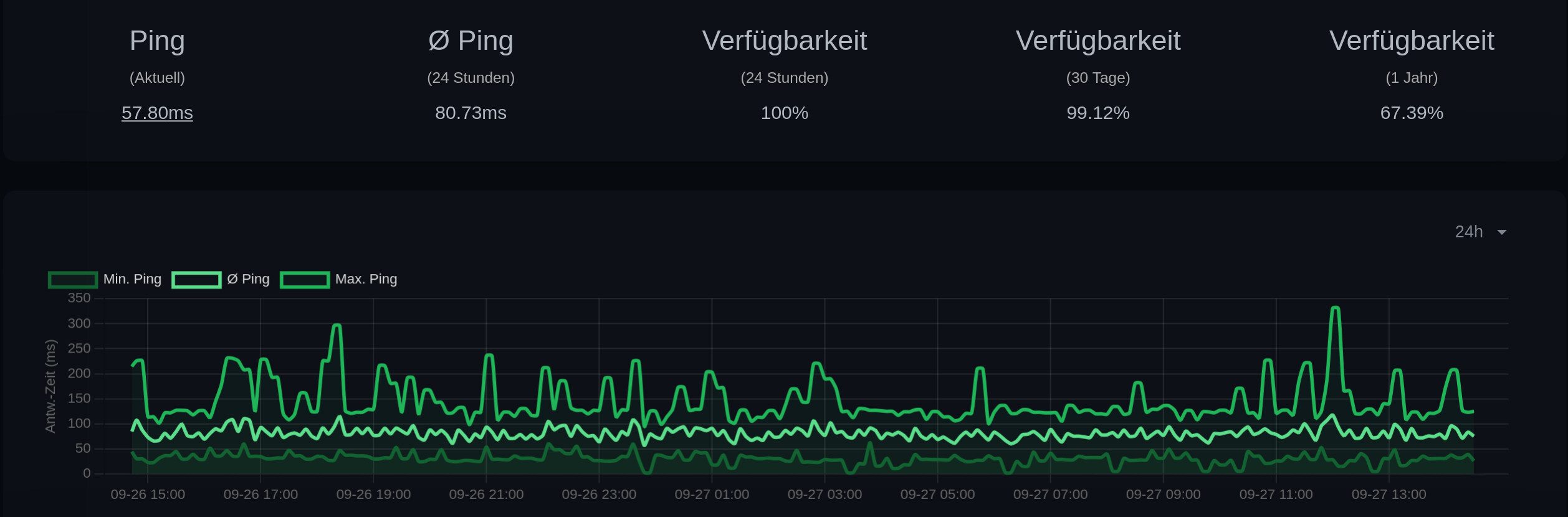

Through monitoring, I could see that the ping times fluctuate between 5 ms and 500 ms.

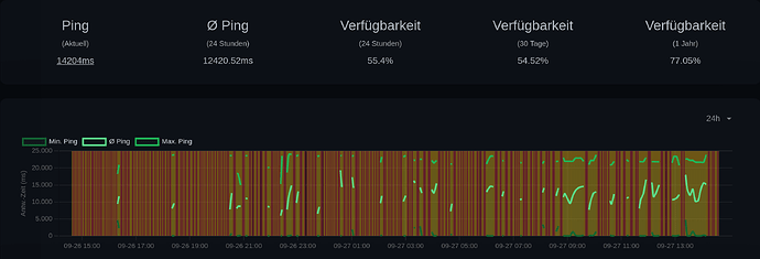

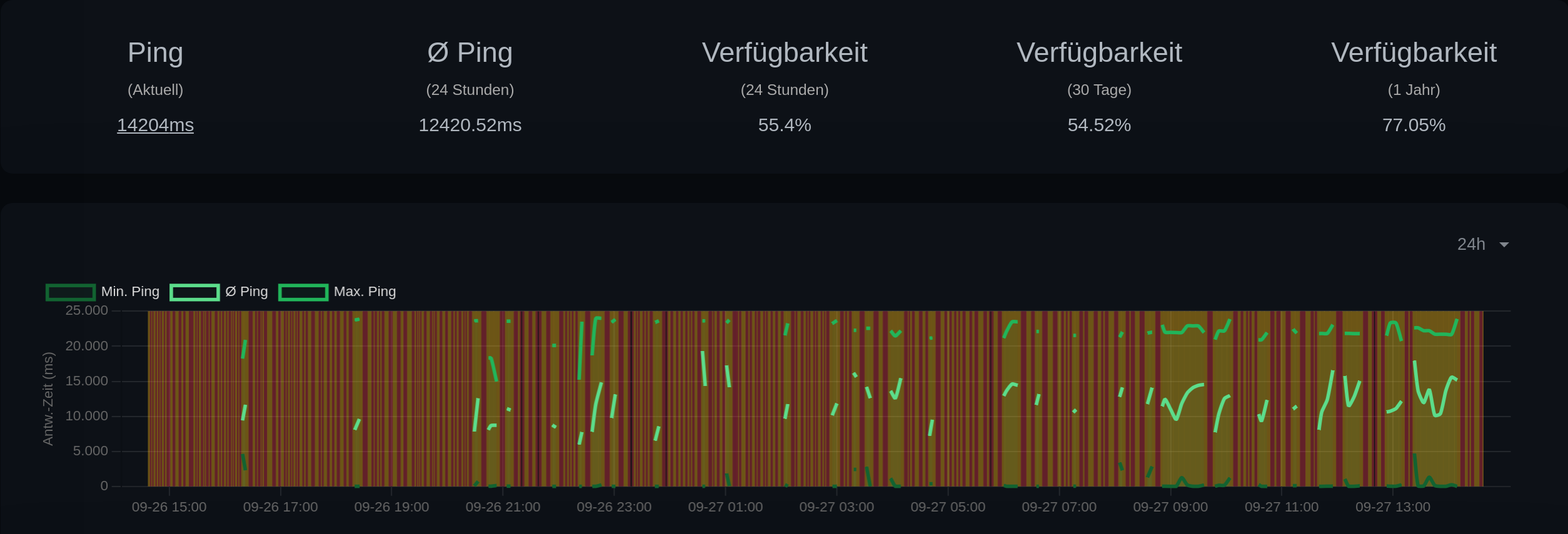

Of the two, the stove maintains the connection “best,” with latencies ranging from 1,000 ms to 40,000 ms — yes, 40 seconds.
The range hood usually drops the connection completely after 4–5 hours.
What I’ve noticed is that when I have the devices running and have first completely powered them down via the circuit breaker so they can reconnect to the Wi-Fi, the latencies are really good (50–500 ms).
If I turn them off, the latencies immediately become extremely poor.
