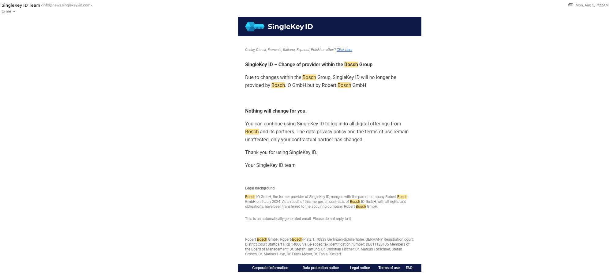

Possibly related to this email:
@laursen is there any chance for an updated binding or a way to re-authenticate?
