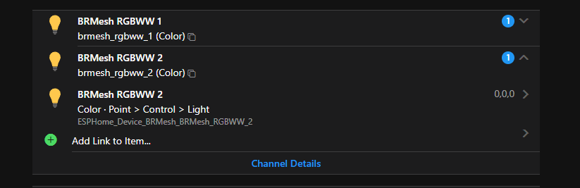

I know enough to be dangerous and got the ESPHome flashed from the GIT repository here with a little help from chatgpt to help me modify the code to allow Openhab to call the White channel through a bit of a hack as the White channel is not exposed.
I modified the code where if the HSB is 0,0,XXX it will send the white channel activation. Otherwise it will use the standard RGB layout.
Editing the fastcon_light.cpp with chatgpt gave me this option

Now i have a Bluetooth mesh network of 2 and hopefully many more.
There are some disadvantages here… its one way only communication. I dont know if BRmesh can be queried for status. Also it works well but you need to space out commands. The payload works very similair to the tuya scene payload.
Just wanted to share.. i learned a lot and if anyone else is interested please take a look and see what you can contribute to this project.
