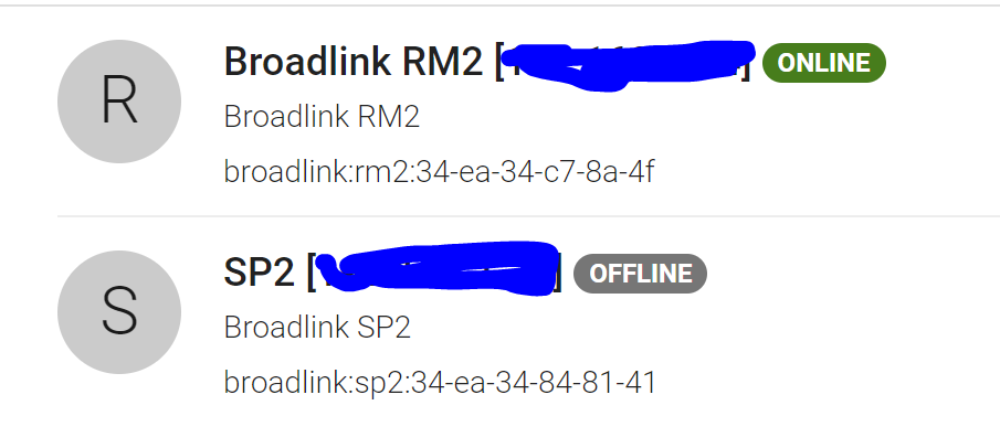

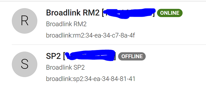

I have successfully binded my RM2 and SP2 device to openhab. However, i noticed that the status of the Things always flip flop between Online and Offine status as show in the screen below.
Inside the openhab.log, i noticed the following:
2017-12-17 12:26:18.547 [ERROR] [nk.handler.BroadlinkBaseThingHandler] - IO error for device ‘broadlink:rm2:34-ea-34-c7-8a-4f’ during UDP command sending: Socket is closed
2017-12-17 12:26:18.551 [ERROR] [nk.handler.BroadlinkBaseThingHandler] - IO error: Broadlink Device: Socket is closed
2017-12-17 12:26:48.593 [ERROR] [nk.handler.BroadlinkBaseThingHandler] - IO error: Broadlink Device: Socket closed
2017-12-17 12:27:18.652 [ERROR] [nk.handler.BroadlinkBaseThingHandler] - IO error: Broadlink Device: Socket is closed
2017-12-17 12:27:48.708 [ERROR] [nk.handler.BroadlinkBaseThingHandler] - IO error: Broadlink Device: Socket is closed
2017-12-17 12:28:18.760 [ERROR] [nk.handler.BroadlinkBaseThingHandler] - IO error: Broadlink Device: Socket is closed
Does anyone faces similar issue or is it just me?
