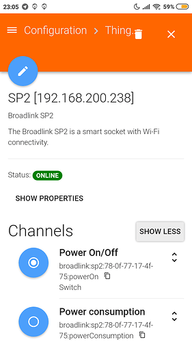

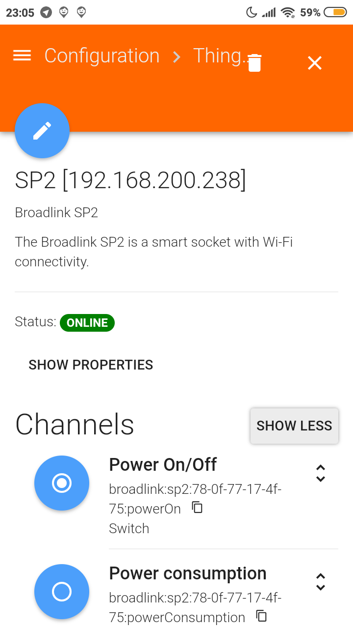

Just wanna share that it works with a Broadlink SC1 (https://m.banggood.com/Broadlink-SC1-DIY-Smart-Switch-WiFi-APP-Control-Box-Timing-Switch-Wireless-Remote-Controller-p-1143214.html)
Using beta10, device is found as SP2 - probably the same hardware.
Everything works properly after putting the authentication and IV key.
